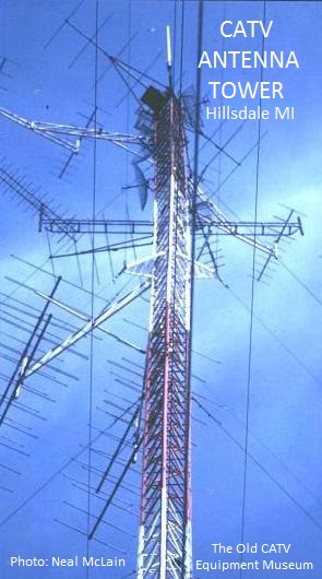

I am always amazed when someone wants a simple system that duplicates what a CATV system headend does with multiple antennas, amplifiers, and modulators costing thousands of dollars. You will need to cut back on your expectations and settle for improving one direction or be prepared to spend a lot of time and money building a system that does what you want.
http://forum.tvfool.com/attachment.p...1&d=1433119191
