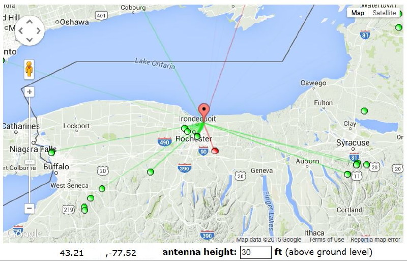

I have been using a very large directional Winegard UHF/VHF antenna (not sure of model) along with a mast mounted winegard pre amp mounted on 20 foot of ROHN with an additional 10 foot mast and digitally operated rotor.I have 75 foot of quadshield split to 5 TV's.The biggest challenge is the numerous large trees in just about every direction.Windy days are the worst for reception but overall I get what I should.
My location is interesting in that I am 6 miles from Rochesters locals and 65 miles east from Buffalo & 75 west from Syracuse locals.I get Canadian programming off the back of my antenna on occasion without rotating(Most likely due to nearness of shoreline to Lake Ontario).
My goal is to see if I can optimize reception from as many markets as possible including canadian programming without the need of a rotor.I know its unlikely to be all the time but I have been inspired by reading these forums and some of the configurations are very interesting.Any and all help on antennas and configurations are greatly appreciated.Here is my TV Fool report.
http://www.tvfool.com/?option=com_wr...f1f09b7abbf6c3
Thanks in advance,Joe.

Hello neighbor! , Interesting...Seems Hi-Tech :) So I am not the only one trying to pull this off.willing to research any and all combinations that can effectively collect signals VHF & UHF from different directions.
Anyone had a chance to look at the TV Fool report to weigh in on the possibility of reception in this location without a rotor?

If you have 20 ft of tower and 10 ft of mast, why did you enter 15 ft AGL for your tvfool report? You need all the height you can get for your plan, especially with trees. Here is your report at 30 ft for your estimated location:
http://www.tvfool.com/?option=com_wr...f1f0febab36d07
and at 50 ft:
http://www.tvfool.com/?option=com_wr...f1f056e6796d1a
http://forum.tvfool.com/attachment.p...1&d=1429902377
You have some strong FM signals that might cause a problem for your preamp. See the second attachment.

What I am interested in trying is to do the same without the use of a rotor.Based on my report and proximity to the various transmitters I am interested in a new configuration & hoping to not have to rescan & point etc...
I agree with stvcmty. You need 3 antennas, and a way to combine the signals into one coax before splitting.
If you only had one TV, I would say use an A/B/C switch to select the antenna you want and use a Sony TV that can add a channel after scan, to avoid the need to rescan every time you switch antennas.
joes1971 24-Apr-2015 7:49 PM
Rabbit,my existing equipment is as listed in the dialogue, the report elevation was an error sorry for that.30 ft. will be most representative of what I have and likely the most elevation I will get.(Wife):)
I have seen some posts with reference to combining different antennas into one coax & also panel style multi-directional antennas as well.
Based on my report at 30 ft. what hardware variations are being used that folks are having good success with?
Regarding the FM signals will the amp trap help or fix issues with this?

I am looking more now at an antenna choice to capture the Rochester market & possibly the majority of the Buffalo Market in the range from 208- 260 degrees while sacrificing the balance of the Buffalo Market at 270-290 as its probably not within the beam,miles or desired channel interest.
I am using the above TV Fool report at 30'.
16 channels are UHF(between 6 & 70 miles) while 2 are VHF (at 6 miles).
i'll keep my rotor for now as I don't see a solution to combine the canadian programming as easily as I had hoped.
