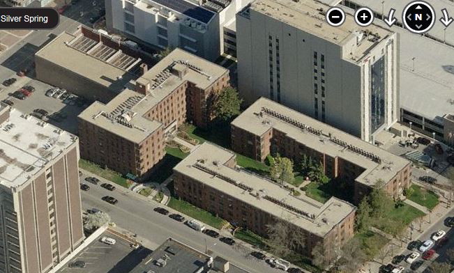

1 Attachment(s)
Welcome to the forum, teegee:
Oh, Wow! This looks like a serious multipath reflection problem, with signals bouncing around in all directions.
Your signals are very strong, but you will need to do a lot of experimenting with indoor antennas and their location. If you extend your coax with an F81 coupler you can add more coax to allow more choices of location.
If your apartment has a window that faces SW without lowE glass or a metal screen you might be able to put your antenna inside that window with promising results. If not, you have a lot of trial-and-error ahead.
Maybe you are lucky enough to have a balcony.
Your antenna doesn't have an amplifier, which is good because it probably would be overloaded. Your antenna works better for UHF than VHF-high, real channels 7-13 (not virtual channels).
You might have better luck using a small outdoor antenna inside because it will be more directional to reject some of the reflected signals in that congested area.
http://forum.tvfool.com/attachment.p...1&d=1429662835

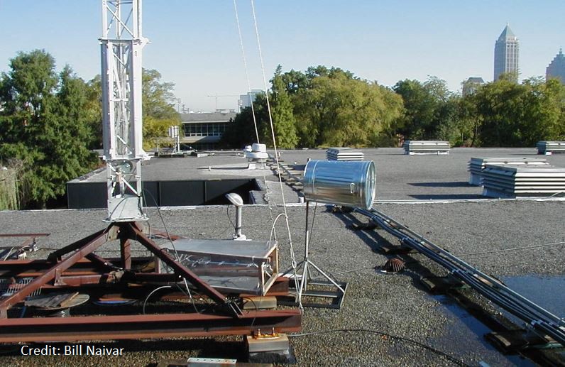

Bill Naivar's Anti-ghosting Antennas Revisited
9 Attachment(s)
The links to Bill Naivar's Anti-Ghosting Antenna to minimize multipath reflections were blocked by my Norton Internet Security, but I was able to find enough images at Google to describe his experiments, while giving him credit for his images.
Bill's first anti-ghosting antenna was a Winegard PR-9014 UHF antenna in a screened enclosure. See Attachments 1-3.
He used a spectrum analyzer to view the shape of the digital signal to look for signs of multipath. This is not always a fool-proof method to detect multipath as Trip in VA found out. It is possible to have a good looking trace, even when there is a serious multipath problem. This is because the reflections can fill in the dips in the trace. The analyzer records amplitude during the trace, but doesn't account for time differences between the original signal and the reflections according to Dr. O. Bendov in his paper DTV Coverage and Service Prediction, Measurement and Performance Indices.
See Attachment 4 for the bad looking ragged spectrum analyzer trace by Bill, BEFORE using the anti-ghosting antenna. Attachment 5 is the good looking spectrum analyzer trace, using the Winegard PR-9014 anti-ghosting antenna.
Chattanooga: Trouble getting OTA Signal
http://www.avsforum.com/forum/25-hdt...l#post22156611 post 25
http://www.avsforum.com/forum/25-hdt...l#post22172949 post 26
Bill's second antenna was a double bowtie in a trash can which gave better results. Attachments 6-8.
Can you see the anti-ghosting antennas built by Bill Naivar of Georgia Tech in this photo?
http://forum.tvfool.com/attachment.p...1&d=1430614434
I took a standard UHF bowtie antenna and mounted it to the bottom of the can. The metal bottom makes a great back reflector, the can provides the multipath shielding, and the U-bolt that came with the antenna mounts the whole thing on the pole. (I can even use the handles to tie guy wires to so that the wind doesn't move the can.) I mounted a F-81 barrel for the coax connection. And I even got 2 dBmV MORE signal level than my original design!
http://mackys.livejournal.com/713021.html
Attachment 9 is the spectrum analyzer trace for the double bowtie in the trash can.

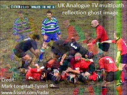

1 Attachment(s)
Analog multipath in the UK causing ghosts.
http://www.frisnit.com/radar/
Can you see the ghost image?
http://forum.tvfool.com/attachment.p...1&d=1429801922
