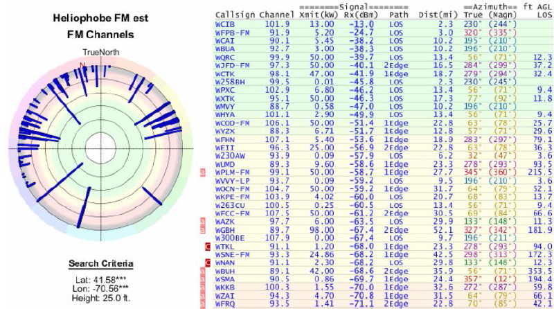

If you do use a preamp, you will probably need an FM trap, because WCIB is very strong at -13 dBm.
http://forum.tvfool.com/attachment.p...0&d=1429635634
