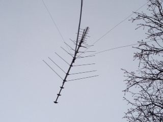

Need advice on replacing old antenna is on hill about 20 feet off the ground and about 75ft from the house amplifier is a radio shack #15-1108 that has the gain turned all the way down all cable is RG6. Also RF MoCA Amplifier - Passive Return CATV Amp: PCT-MAB-F14P running to 5 sets. Now receive every thing in the green, yellow and red but 35-1, to 35-3 is not viewable most of the time. May need 2 antennas due to the tower location.
The old antenna.
Attachment 897
GroundUrMast 13-Jan-2015 5:20 AM
One of my favorite combinations is the Antennas Direct DB8E + Antennacraft Y10713 + RCA TVPRAMP1R. Your report is one of the many that that combination fits very well.
I'm keeping my eye out for a new preamp from Antennas Direct... Until then, this combo gives you maximum performance and the greatest flexibility when fine tuning antenna aim points. The usual install puts the UHF antenna at the top of the mast and the H-VHF at least 3' below the bottom of the upper antenna.

If you are receiving everything well now, I don't quite understand why you would want to replace anything.
By channels 35-1 to 35-3, do you mean KRSU? If so, it is in a different direction than the majority of your other stations plus has a weaker signal which would explain your reception issues with it.

The old antenna is in bad shape elements falling off and pole allmost rusted into.
