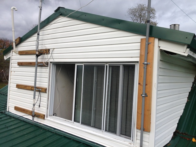

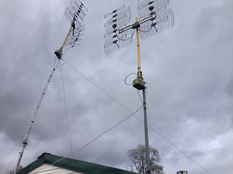

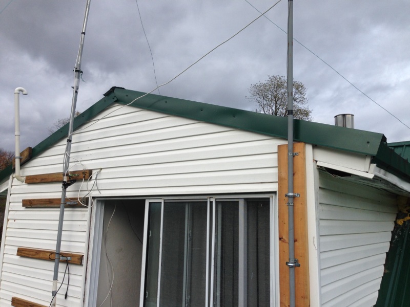

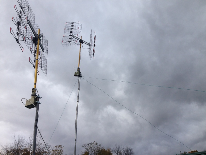

Situation: our main goal is to have reception of the following channels at one time - 2, 3, 4, 6, 8, 10, 16, 19, 23, 53. If we have to live without some of those channels, OK, but I know for a fact we can tune 2,3,6,19,53 at same time because I had it working properly.. Then my dad got involved. Now I can't get it back, no matter what I do. As long as I can get 2,3,6,19,53 then we can survive.. Obviously any other channels a bonus.
So, we have two identical antennas on separate poles at the moment, each with its own rotor. They are approximately 8 feet apart side to side, with one about 4 feet below the other. We also have three TV's on 3 floors. 1 top flr, maybe 20ft of cable run. 1 mid flr, maybe 20 ft of cable run. 1 bottom flr, probably at least 50 ft cable run.

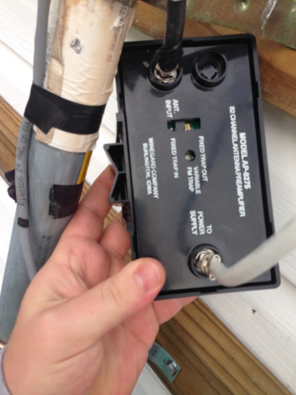

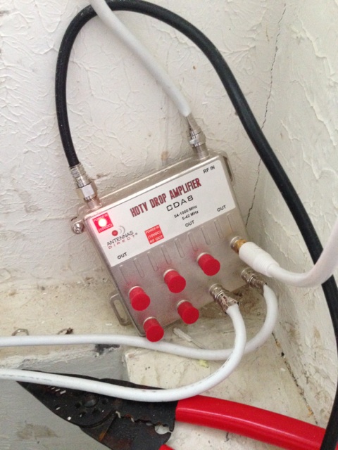

The two identical antennas are Antennas Direct Model DB8e Ultra Long Range Multi-Directional. The one drop amp is an Antennas Direct CDA8. It has 8 outputs. I also have a Winegard Model AP-8275 82 Channel Pre-Amp.
We also made sure to have the cable from each antenna to the splitter the same length, perhaps off by 2 or 3 inches at best.

If I am understanding correctly you have a preamp feeding into a distribution amp? Double amplification can get tricky. Therefore, first thing I'd do is yank the preamp. Overload can manifest itself in reduced reception. Did you recently install the preamp?
Second, if I were doing this, combing antennas is not your goal here. If I'm reading your set up correctly, both systems are not separate. I would separate them via an A/B switch. Often if you are combing two antennas designed for the same band without any filters or bandpass you set up the stage for signal clashing. This will exhibit itself as reduced reception.
I have two antennas at my location. Both are on completely separate coaxes and they have different missions. They both work exactly as intended and I switch between them via A/B switch.
If I were you, I'd get one antenna feeding into the house, confirm it's working. Then, undo it, connect other antenna and confirm it's working. With a A/B switch inside then you can toggle between antennas.
It's not perfect, but when you are chasing UHF signals with two UHF antennas, you've got to let them work without another antenna introducing clashing signals.
Now there are methods to tie two same band antennas together, but as I mentioned, those require specific bandpass and filtering. It appears you don't have that.

Thanks for the reply Stephanie. Currently the pre-amp is not hooked up, just the drop amp from antennas direct.

even though they are "multi-directional", it seems they still need pointed.
Yes, they do. Multidirectional does not mean omnidirectional. The technical data sheet on our website (under the "Documents" tab on the antenna's web page) shows the expected reception patterns.
I always advise customers that trying to combine multiple antennas facing in different directions is a total crap shoot. It works okay for some folks, it doesn't for others. I gave up a long time ago trying to make it work and have since relegated to an experimental project status. Give it a try. If it works, then mozel tov! If it doesn't, at least you gave it a shot.
