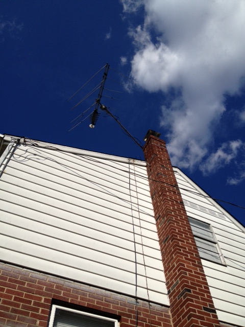

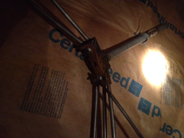

Was outside gardening and looked up at the roof and realized that I have another option! I have a huge antenna on my chimney that I was going to take down and scrap but now realize that it may well be the answer to my unreliable reception of ABC. I see wiring running down the side of the house going into the basement. In the attic I found a second antenna (at least I don't think it's attached to the chimney antenna) with a flat cable running down to I don't know where yet. I haven't tried tracing where the cables are going yet because I think I need more info before I try.

Tower Guy 6-Jul-2014 9:04 PM
The old antenna is likely to break when you try to replace the twin lead with a new balun. I'd take a look at the HD7015 from Summit Source. It's smart to use new coax for your distribution system.
tomfoolery 7-Jul-2014 1:29 PM
The antenna in your attic reminds me of this style, popular in the 50's when TV was exploding in suburbia.
http://i456.photobucket.com/albums/q...6nx7d7gl3w.jpg
If it were me, I'd focus on the Philly stations, and since they transmit on all bands, all the way down to real channel 2, I'd just use a (new) full-range antenna pointed at about magnetic 30 degrees, mounted in place of the old one. I don't see anything in the Atlantic City market that you can't get from the Philly stations.
I'd also run new cable outdoors, at least to one TV for initial setup, and look into reusing some of the old stuff once it's working to your satisfaction. I would not wire up the whole network, especially with old cable and splitters, before establishing what the system can do in its cleanest configuration.
