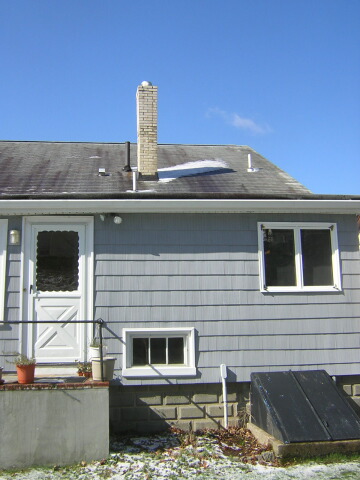

Reading some older threads, chimney instllation is suggested instead of drilling through the roof.
Here's my chimney -
http://forum.tvfool.com/attachment.p...1&d=1397656293
Any comments? Looks like I could add a mast and easily get above the roof peak. My main question is - where do I run the wires, across the roof or down? I understood that going through the roof with the wire(s) would be bad, since it penetrates the shingles.
Re the grounding, when an electrician ran the service to my separate garage, he buried two ground rods in the service trench rather than driving them into the ground. The ground is very rocky here, and it's unlikely that I would be able to drive a rod into the ground fully. Maybe I could follow his example?
And here's my radar plot, if it's relevant - http://forum.tvfool.com/attachment.p...1&d=1397656293

I try to avoid traversing the roof with coax. It provides a place for debris to get caught and then create a dam to water and ice. I prefer to run down to the edge and then proceed under the eve or soffit.
But as I look at your photo, I wonder if a set of wall brackets would be even better. I've yet to have any leak issues with a mast supported by wall mounted or gable end mounted brackets.
Re. grounding, I'd suggest you not add another ground rod, but run the mast and coax grounds to the existing electrical service ground. You want to use the same ground system any way, and an added rod would require that you tie it to the existing ground system to ensure there is minimal voltage difference between the existing and new ground rods.

I thought about burying an additional ground rod because of the drawing here - http://www.hdtvprimer.com/ANTENNAS/basics.html - that shows a ground rod plus an NEC-required #6 copper run. Service to the house is grounded to the water pipe from the street that emerges in the basement, before the water meter. Tying into that should be straightforward. However, this is roughly 30' from where the ground wire might enter the basement. Using #10 solid Cu wire as in your post #20 would be a considerable savings over the #6 wire suggested in the earlier link. I wonder if the #10 is up to a proper lightning discharge. Looking at lightning rod wire, it's a #1 open braid at about $2 per linear foot.
The roof peak is about 24' off the deck, and there is a location around the corner from the picture that would support a 30 foot-ish mast from eves at about 12 and 20 feet (picture will have to wait for daylight). But I'm unsure about how a mast like that would be erected - ie whether the antenna(s) would be assembled to the mast, or if the antennas would be assembled to the mast after it was erected.
You mention roof brackets - the roof you see in the foreground of the picture isn't that high - maybe 12'. So that's another 12' to reach the roof peak. The location around the corner seems more practical, if using brackets. Then run the mast to the ground. Steel tube is cheap compared to heavy copper wire.

Looking at this a little more, I notice that the roof has an abandoned bathroom vent next to the chimney. I could take that over as my wire entry point (the alternative is to drop wires over the side of the house and go through the shingles and sheathing into the basement stairwell, where the small low window is). The mast ground could then follow the stack chase down to the basement floor, around the perimeter of the basement, and close to the current water pipe service ground attachment. See any issues with this?
The coax could also follow the stack to the basement, but there it must leave the stack. Whatever I end up with, the coax must diverge from the mast ground quite a ways from where the mast ground would be bonded to the service ground.
Now, your post #20 says to install a ground block and "connect it to the electrical service ground at the same point you connected the mast ground." That could be interpreted as sending the ground block wire back to the water pipe where the service ground is. I don't see any need for using a parallel conductor to the mast ground, as long as the coax ground ties into the mast ground before they diverge.
You also advocate "reasonable steps to encourage fault current to stay outside my house" - so you would take the mast ground around the perimeter of the house to the point of entry with the shortest path to the service ground? Doing that, the ground block would be way far away from the service ground... so put the ground block where they diverge, up by the mast?
