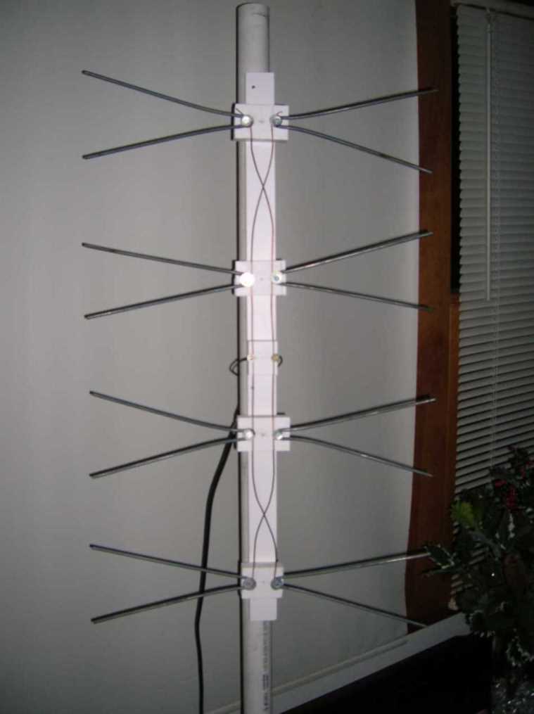

I've recently (the past two weeks) been learning about OTA and built three different 4 bay units for testing basing the design from http://m4antenna.eastmasonvilleweather.com/index.html
What I have done and what my hopes are. -– Drop Cable TV – See my tvfool report below*
1. 4 bay (1st test)
  • 9.5” whiskers, 9” spacing, 3/16” dia. metal whiskers (very sturdy). 1 1/2” forward bend.
  • No reflector.
  • #14 copper phase lines.
  • CM-94444 Balun and or Radio Shack Balun.
  • 10' RG6 cable
1. Interior test got the following.
  • WTBY-TV 27
  • WTNH-DT 10 (8.1) ABC
  • WZME 42 (43.1)
  • WRNN-DT 48 (48.1)
  • W22BN (Not interested)
  • WVIT-DT 35 NBC
2. 4bay (2nd test)
  • 9.5” whiskers, 9” spacing, 3/8 copper tubing whiskers.
  • No reflector.
  • 10' RG6 cable
  1. Interior test. This seemed to get a few more channels than the 3/16” metal whiskers unit above but can't remember for sure.
  2. Flattened the copper where the two whiskers came together for screw hole attachment. This seems to be an area that would and did bend very easily.
  3. Elements broke (dropped), decided to move on to different build.
3. 8 bay (4 bay side by side 26” spacing between) (3rd test)
  • No reflector.
  • Co-phase lines connecting the two units together #14 wire non-stripped other than at connection points. They are separated by 1” using 4 plastic blocks with holes to feed wire through them. Both are exact length. Single balun connected at middle of phase line.
  • CM-94444 Balun.
  • About 100' RG6 cable.
  • No amplifier
  1. This thing picks up some channels!
  2. Exterior test outside, mounted at about 18' from ground. Temp set up of pvc pole securely fastened to house wall up to 14'. The last 2' had a union and a 35-50 mph wind gust broke the union connection. Yeap it came down! No damage other than the unit itself. Rebuild needed.
  3. Antenna was pointing at about 227 degrees compass. Picked up the following channels (Attachment 700)
  4. 4. Best I could tell from the TV info the signals were at around 50 % +/- on most channels (is this good bad or normal?). I noticed a few lost connection at times. It was a little windy and thought that had something to do with it.

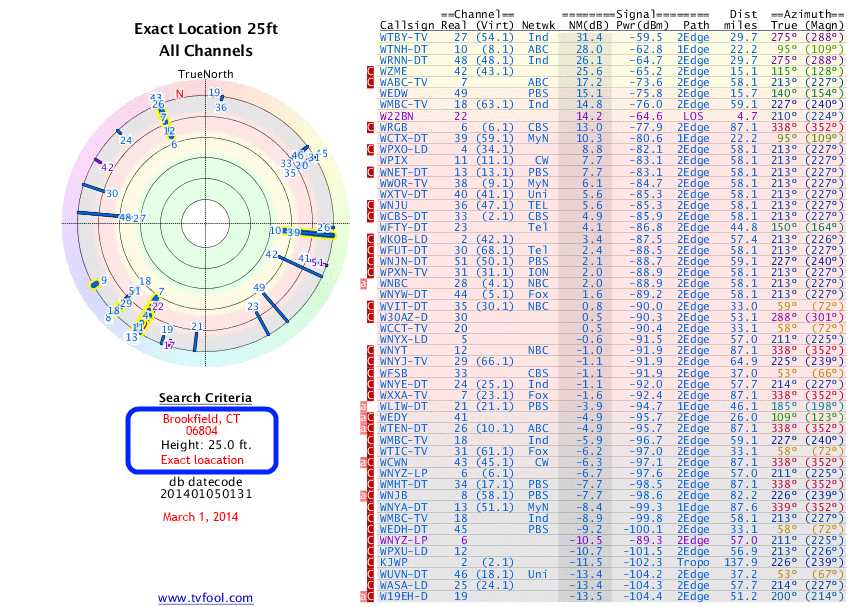

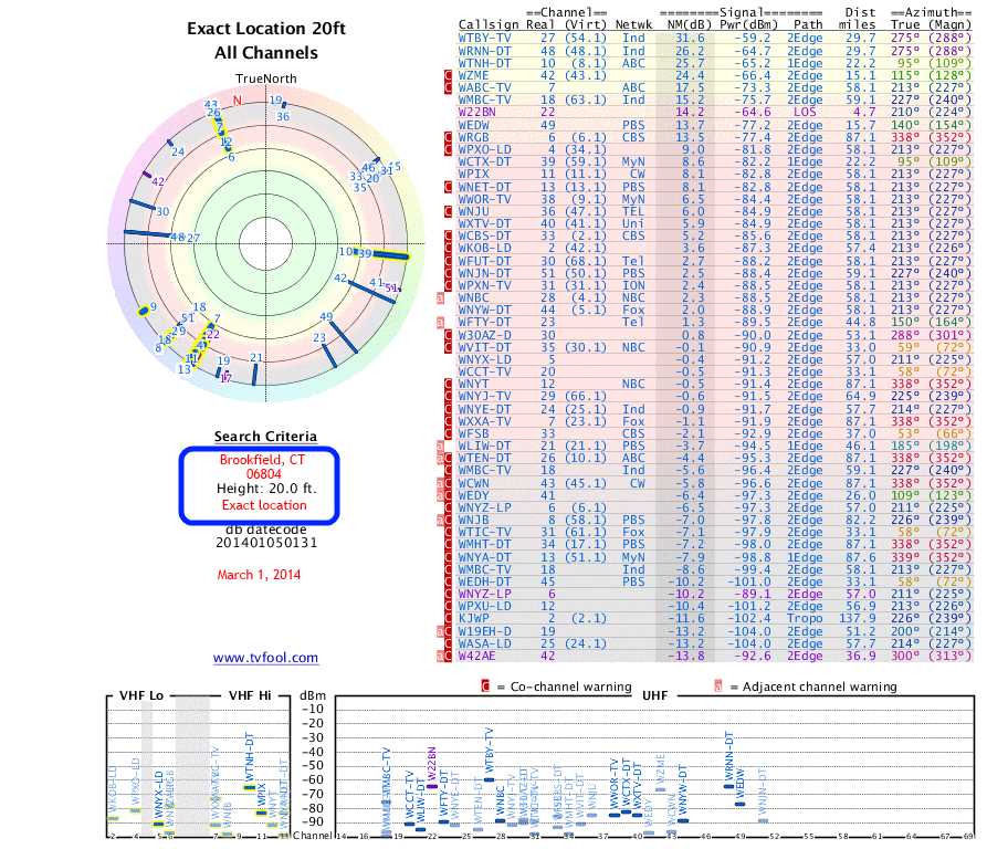

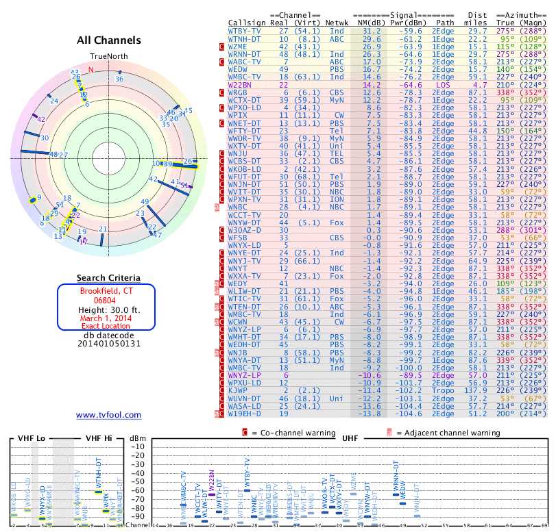

TV Fool at 20' or http://www.tvfool.com/?option=com_wr...46aed6c9ffbc1d
TV Fool at 25' or http://www.tvfool.com/?option=com_wr...5b9403fa207f4a
TV Fool at 30' or http://www.tvfool.com/?option=com_wr...5b94ff74ae86b1
I've attached some images which show exact location info from TVFool. There is also a speed sheet showing what received channels (signal) came in for the 8 Bay unit during its short life.

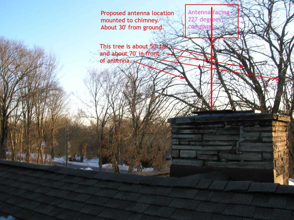

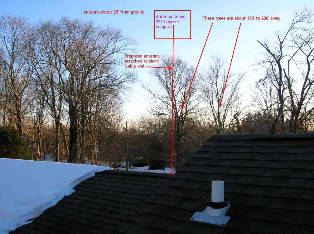

Antenna to be installed above rooftop either chimney or gable mount about 20' - 30' off ground in total.
  • TV = one
  • Cable run about 100'.
  • Mounting pole = 1 1/4” metal emt.
    1. Gable mounted 10' emt pole would only have about 2' of base pole mounting area due to another roof below giving a 20' - 25' ground height.
    2. Chimney mount would be the higher (25' - 30') but there a some trees in LOS (227 degrees) about 70' away and maybe about 20' higher (50' from ground).

For reception of as many Digital Broadcast Tv Stations/Channels as possible in the directions of , West , South West , South , South East , East.
With 1 antenna aimed in 1 direction.
At 30 feet antenna height or higher above ground.
Install a , http://www.antennacraft.net ,
HD1800 All channel antenna.
10G201 preamplifier.
The 10G201 preamplifier will be operated in the combined antenna mode.
The FM radio trap switch of the 10G201 preamplifier will be in the in/on position.
Aim the , HD1800 antenna at about 227 degree magnetic compass direction.

As always , trees and tree leaves , plants and plant leaves , have a Negative Effect on Broadcast Tv Reception and so do buildings and other obstructions including your own roofs and buildings.
Some and not all Negative Effects are.
Absorbing and Blocking Reception.
Multi-Path Reflecting Tv Signals Bouncing All Around.
The Best Practice for Reliable Reception is to install the HD1800 antenna at a location that has the least amount to no amount of obstructions of any type or kind in the directions of reception including your own roofs and buildings.
