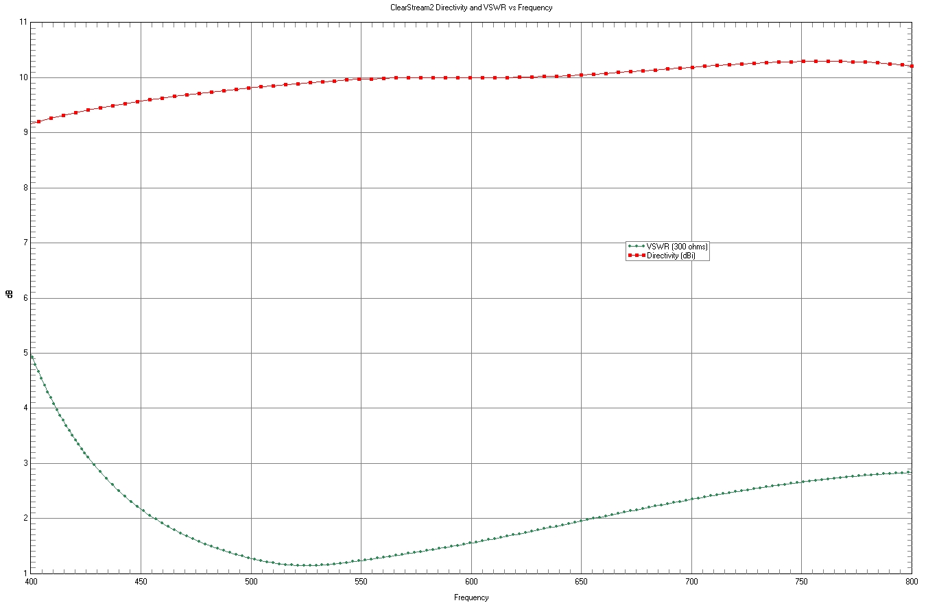

GroundUrMast 14-Mar-2014 9:42 AM
Antennas Direct generally offers more comprehensive data than any other consumer grade antenna manufacturer.
http://www.antennasdirect.com/store/...V-antenna.html
http://www.antennasdirect.com/cmss_f...D_Patterns.pdf
http://www.antennasdirect.com/cmss_f...SWR_vs_Frq.jpg
http://www.antennasdirect.com/clears...ntalplane.html
ADTech 14-Mar-2014 11:23 AM
The tech data sheet for the C2V is on the website. Look under the "Documents" tab on any individual products page. If a TDS is available, that's where you'll find it. Not all products have such a data sheet and the web guy hasn't been consistent on putting a link to the TDS under all potential variations of a model so you may have to look in several spots to find what you're looking for. Tip: DB8 and C4 don't have formal sheets, so don't expend energy looking for those.
http://www.antennasdirect.com/store/...V-Antenna.html
