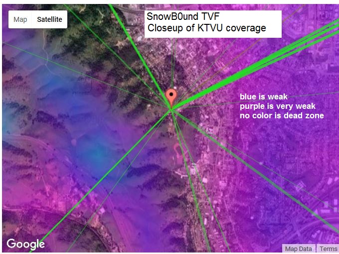

http://forum.tvfool.com/attachment.p...1&d=1507328365
The advice given to you by teleview and GroundUrMast is still good.
KTVU and KRON are much weaker than your signals coming from the NE.
To even have a chance for them, you would need a separate antenna system with a high gain UHF antenna aimed at 211 degrees magnetic and a preamp.

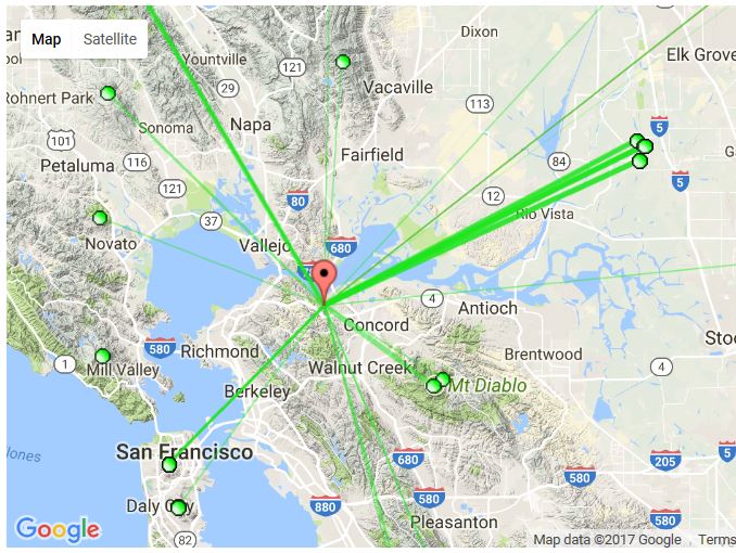

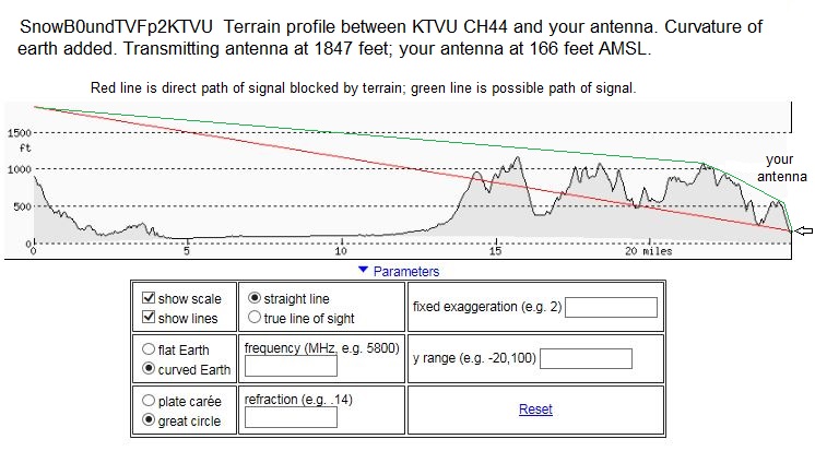

http://forum.tvfool.com/attachment.p...1&d=1507335164

First, you set up a separate high gain UHF antenna aimed at 211 degrees magnetic and a preamp to see if it is even possible to receive KTVU and KRON at your location. This separate system should be connected directly to a TV for the test.
Sometimes it helps to tilt the front of the antenna UP if your location is behind a hill.
At this time of year, there might still be some Tropospheric Propagation to help you. When the cold weather comes, there will be less tropo to help you.
Doing a report at 40 feet doesn't seem to help you because you are well below the peak of the mountain and very close to the mountain. If the signals were just grazing the crest of the terrain, it would make a bigger difference.
