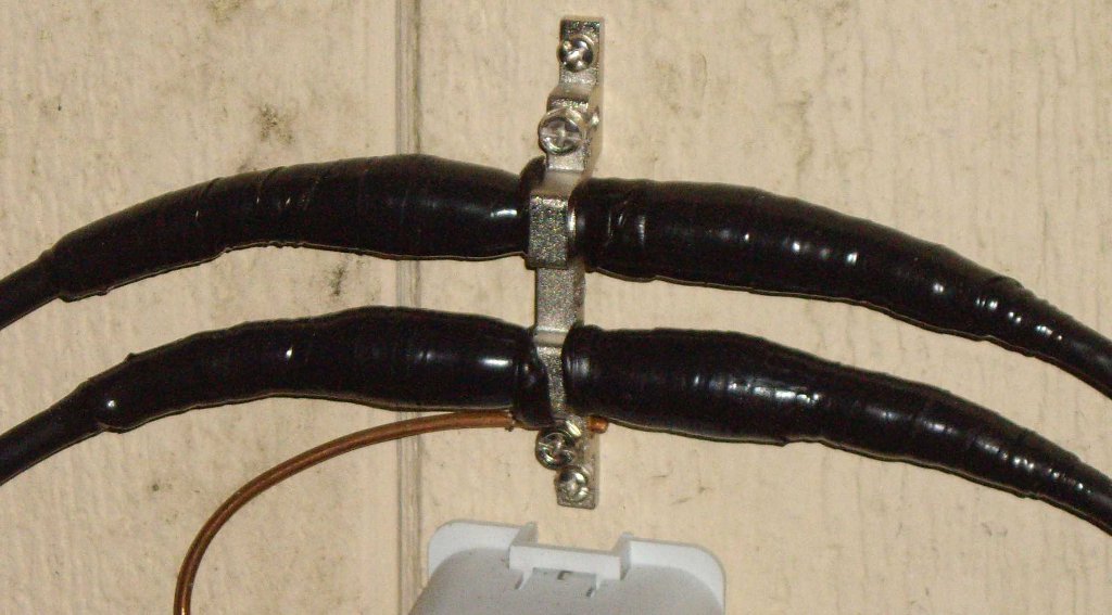

1 Attachment(s)
Keep an eye out for water running down the coax and into the house. A drip loop would be best practice.
Consider wrapping the connectors with Coax-Seal or Scotch 2228. I also put a protective over-wrap of electrical tape over the mastic.

Yes I know, I ran that bedroom cable a while back before I was educated on the basics and there isn't enough slack in the basement to create a loop. Plus the cable was a pain to run (I had to use lube). I used the gray electrical putty stuff though and I'm pretty sure It's keeping moisture out.
I'll look into Coax Sealers but honestly I might just paint it. The old Comcast block was painted and seemed to protect it pretty well.
