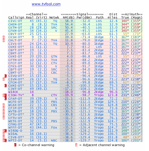

OK, well now I know not to bother. I had figured that there might be special high end antennas not commercially available that could be worth it.
So as requested, here is my TVFOOL report:
Attachment 473
The channels I'm mostly interested in are 75 miles away on the 222* azimuth.
The antenna would be roughly 30 feet high with a clear view in that direction (residential neighborhood with no building over two stories).
Plan to have only one TV setup initially with about perhaps 80 feet of cable. If results are good, might add second TV with an additional 20 feet of cable.
Thanks again:)

Please do not take pictures of a tvfool report.
As the other question askers do , please provide a , Live and Active Tvfool Report.
Use the Exact address to make the live and active report and make the antenna height 30 feet.
Your Exact address will not show up in the final live and active report that you will post.
Something Odd about the tvfool channel list with no radar report map.
CIVC , French Tv.
CHEM , French Tv.
CKTM , French Tv.
CKFM , French Tv.
CBVT , French Tv,
CHLT , French Tv.
CIVS , French Tv.
CBFT , French Tv.
And -->more French Tv stations transmitting the same French programing.
Where is this place with so many French Tv stations??
As the other question askers do , please make and post a Live and Active tvfool report , not a picture of a report.
Use your exact address to make the report and make the antenna height 30 feet.
Peter R. 13-Feb-2013 2:16 AM
Hi Teleview,
I live in Quebec, thus the reason for all the french channels, and the reason I'm mostly interested in channels from the 222* azimuth (from Montreal) is to get english channels.
A lot of the channels are basically identical but with slight programming differences and local advertizing.
Here is the requested report:
(please click "current and pending", most pendings are now active)
http://www.tvfool.com/?option=com_wr...1dda61084064c5
Just out of curiosity, what was wrong with posting a picture of the report?
Cheers,
Peter
teleview 13-Feb-2013 4:06 AM
Based on the Receivable Digital Pending Applications Included English Language Tv stations/channels.
CKMI-DT UHF channel 20 - Global.
CBMT-DT UHF channel 21 - CBC.
CKMI-DT VHF channel 11 - Global.
CFCF-DT VHF channel 12 - CTV ONE.
______________________________________________________________
Antenna system A.
I recommend for reception of.
CKMI-DT UHF channel 20 Global , aim a Channel Master CM4228HD UHF antenna at about 71 degree magnetic compass direction.
For 1 Tv connected use No splitter. No preamplifier.
For 2 Tv's connected use a Channel Master CM3412 distribution amplifier.
Antenna system B.
Install a Winegard HD7698P antenna aimed at about 237 degree magnetic compass direction.
Install a Antennas Direct CPA-19 preamp.
For 2 Tv's connected use a , HFS-2D , 2 way splitter.
Antenna systems , A and B.
Are not connected together on to 1 coax.
Antenna systems , A and B , are Separate antenna systems all the way to the Tv locations.
At the Tv location/s a Remote control A/B antenna switch will be connected to the 2 Separate antenna system coaxes.
Remote control A/B antenna switching is Channel Surfing Friendly , press the button on the hand held remote control , change antennas and keep on channel surfing.http://www.mcmelectronics.com. #32-4425.

GroundUrMast 13-Feb-2013 4:29 AM
Cheers,
Peter
'Wrong' is too strong a word. The static image is helpful, but lacks the HTML links for each call-sign in the list. Those links provide access to path profile information.
Peter R. 14-Feb-2013 1:07 AM
Thanks for all the help Teleview, that FTA link you provided is very eyeopening and seems very promising.
Huh, I wasn't even aware that call-sign links were imbedded in the list. They are pretty neat; really helps one visualize what is going on.
