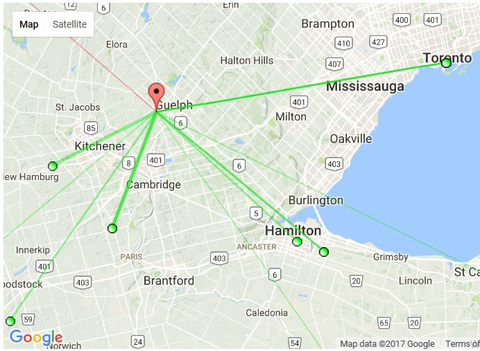

http://forum.tvfool.com/attachment.p...1&d=1506124663

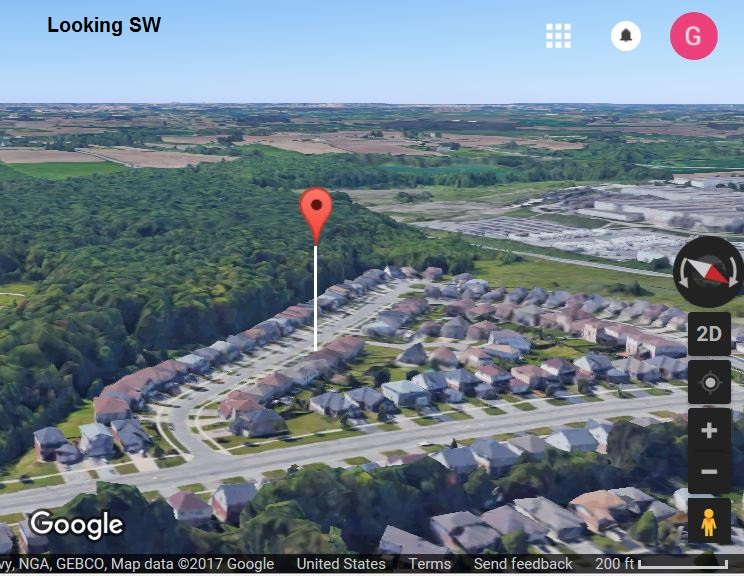

The Winegard HD7696P has been discontinued by the manufacturer, but some dealers still have it in stock.
If you want a smaller antenna for CTV on the satellite mount, I suggest the HD7694P. There are some trees in that direction, but I don't know how high they are now. I picked a house at random in your postal code.

Excellent thanks! I am higher up from the point you used and should clear those trees easily

Side q, where did you use to get the first image with the tower directions from my location?
