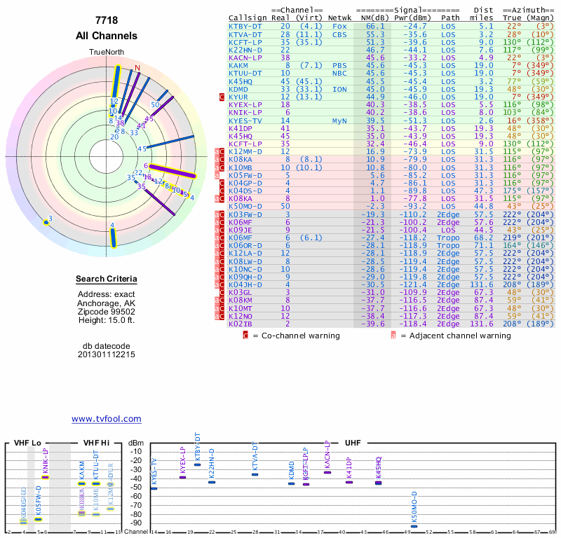

I have a Channel Master 3018 antenna pointing north, why can't I receive channel 11 reliably?

teleview 17-Jan-2013 4:12 PM
As the other question askers do.
Please post a real and Active tvfool radar report plot.
Not a Picture of a tvfool report.
ADTech 17-Jan-2013 5:48 PM
It's only < 4 miles away. You're probably encountering a case of strong multi-path signals.
You can try an attenuator, but usually moving the antenna will solve such situations.
akbgdg 22-Jan-2013 1:04 AM
How do I post a real and Active tvfool radar report plot? Sorry...I'm new at this.
When I receive channel 11, the signal can be very strong(10 bars on my samsung) to very weak to nothing at all. When I receive nothing at all, I'm normally able to rotate my antenna to the North east direction and receive it, but then I start to lose channel 13 and channel 2. Thanks for the help, I really appreciate it.
