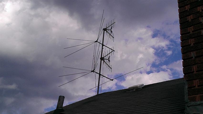

What antenna/setup would work best in my situation?
http://forum.tvfool.com/attachment.p...1&d=1348758678
I have a two story house with a roof mounted old unknown antenna (pic included). I would like to receive WOIO and WJW out of Cleveland, also WKBN, WFMJ, WNEO, WYFX that are all local. I would like to get as many other channels as possible for variety.
http://forum.tvfool.com/attachment.p...1&d=1348759203
I have a tall tree in neighbor’s yard that is just on the edge of the line of site for WOIO-DT CBS and WJW –DT Fox.
I have an HD Homerun (HDHR3-US) installed in the attic, cat 6 network cable running to it, and about 5’ of quad shield Rg6 length from antenna.
So far I’m debating on, Winegard 7698 P, Winegard HD7694P, Winegard HD7084P, Winegard HD-1080, Winegrad HD8200U, or possible to get away with MS-2002.
Would it be better to install two antennas? I was debating getting another HDHR3-US so I could have one for UHF and one for VHF.
I have seen Winegard installed and know they work very well, but I’m open to any manufacture. Would a rotator help since a lot the channels are in different directions?
Any advice would be appreciated, sorry if I left anything out, this is my first post, tried to keep it to the point and enough information.

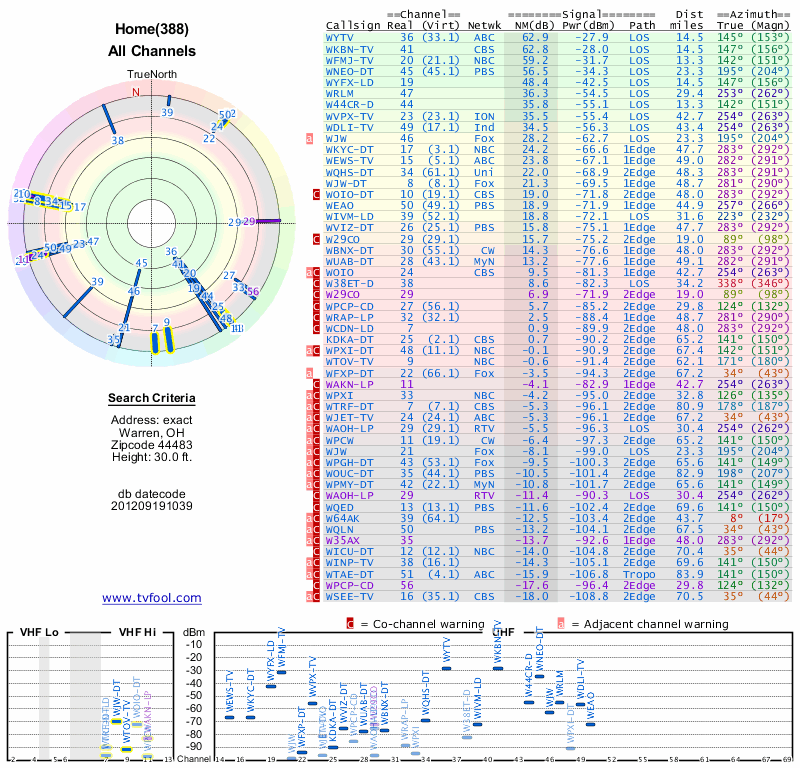

Signal analysis: http://www.tvfool.com/?option=com_wr...2df992d396e4ef
GroundUrMast 27-Sep-2012 6:27 PM
I run several HDHRs
Given your willingness to consider a second HDHR, it sounds like you may want to build a system that terminates a fixed aim antenna on one and a rotatable antenna on the second.
I would use a 2-bay UHF antenna such as the Antennas Direct DB2e facing south and slightly east (fine tune the aim using the signal metering of the HDHR). I would not use a preamp if you're only connecting one tuner using less than 50' of RG-6.
I see no low-VHF on the air or pending, so the HD7698P on a rotator would be a very good choice for going after the more distant signals. Terminate this antenna in the second HDHR.
