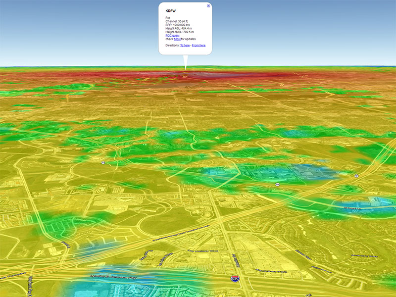

mtownsend 24-Sep-2012 2:22 AM
1 Attachment(s)
Can you post a link to a report for your exact address? Some neighborhoods are shadowed by local hills, and without an address-specific analysis, it's hard to tell whether this is a factor for you or not.

teleview 24-Sep-2012 7:12 PM
->ALL<- Questions and Answers about Broadcast Tv Reception and More.
The following is a Teleview recommendation for broadcast Tv reception.
The Main group of Digital Tv transmitters is to the South with a few a little more to the south east.
Install a Trek HDTVi (not the HDTVa) indoor antenna in a preferably south facing window for best reception , also so can put the HDTVi antenna in the south east window.
A long length of coax can go from the antenna to the Tv.
Aim the HDTVi antenna at about 181 degree magnetic compass.
Here is how to aim indoor type antennas. http://www.kyes.com/antenna/pointing/pointing.html.
Rescan for Digital Broadcast Tv Channels.
