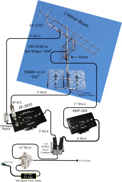

I do not claim to “scientifically” test or even fairly compare multiple antennas. I can, however, report my real world results, recognizing the constraints I’m faced with. Make what you will of the information. I can confirm that lugging antennas and climbing ladders was a lot easier 50 years ago. It must be something in the water?
Since I can’t raise or lower my pushup mast by myself, I fixed mounted the new Solid Signal HDB8X on it below the rotor. The bottom of the HDB8X is @ 21’ 7” AGL, 5’ 9” below the bottom of the 40 year old Channel Master CM-4228 (not a new “HD” model). For the last several weeks, the CM-4228 has been connected through a new white 17’ RG-6 cable to the base of the pushup mast, an F-81 F-F barrel, 50’ of new white Magnavox M61210 RG-6 to a coax switch in the garage. My Winegard YA 1713 was similarly connected through a new black 17’ RG-6 cable, an F-81 F-F barrel to a 32 year old piece of RG-6 that also ran to the coax switch in the garage. During amplifier testing I verified there was no SNR variance @ UHF frequencies between using the new white vs using the old black garage coax runs.
I disconnected the black garage RG-6 cable from my YA 1713 and used that piece for testing the new HDB8X. The garage coax switch was used to switch between the CM-4228 & the HDB8X. The single output of the garage coax switch is connected to a new ~75’ thru-wall RG-6, run to my office computer and Hauppauge HVR-1800 tuner card used for this comparison. In other words, everything from the coax switch in the garage to the point of measurement was common for both antennas.
Using the rotor, I “bump” aligned the CM-4228 for maximum SNR on LA channel 36 (4.1 KNBC) and then, by eyeball, “fix” aligned the HDB8X to match. I purposely did not try to introduce the variance of two separate amplifiers although looking at my TV Fool report amplification is certainly called for: http://www.tvfool.com/?option=com_wr...1dda169109ca5c
The HVR-1800 was tuned to a channel & the SNR recorded, I then ran to the garage to throw the switch, returnd and record the new reading, tuned to the next channel, record it and repeated the process. Measurements were alternated between antennas so that each antennas value was recorded 20~30 seconds apart.
I also included measurements from my <1 year old Antennas Direct 91XG/Antennacraft Y10-7-13. These antennas are tower mounted @ ~40’ AGL and have individual +15 dB PCT MA2-M drop amplifiers connected via either an F-71 M-M barrel for the 91XG or a 300 ohm to 75 ohm BALUM and short piece of RG-6 for the Y10-7-13. The output of each amplifier connects to a UVSJ feeding ~125’ of new RG-6 that connects in my garage to a PCT MA2-4P +8dB/output per leg distribution amplifier one leg of which feeds a separate new run of RG-6 into my office. A different HVR-1800 tuner card & computer were used to take these readings. This is clearly an apple to oranges comparison, but is in-part justified by the fact that when I swapped the 91XG & CM-4228 last summer there wasn’t a significant difference in amplified performance. If nothing else it should be predictive of what I might achieve by adding a +23 dB amplification chain to the HDB8X and mounting it on the tower.
http://www.digitalhome.ca/forum/pict...pictureid=7002
http://forum.tvfool.com/attachment.p...9&d=1372562936
If it were still made, I would certainly recommend the Channel Master CM-4228 over the HDB8X if for no other reason than its High VHF capabilities. Within its design frequency range the unamplified HDB8X average UHF SNR of 13.975 compares favorably to the 13.7429 of the unamplified CM-4228. .23 difference is well within my margin of reading error since the tenths digit for both antennas was constantly changing. Had I been able to align the HDB8X with a rotor I may have been able to improve its SNR, especially for the San Diego stations. Last summer when I swapped out my brand new tower mounted 91XG with the CM-4228 I was really surprised when it matched the 91XG SNR’s within 1-2 dB on all channels. The 91XG was better on slightly over half of the channels but the CM-4228 definitely held its own. For that test I replaced the 91XG’s F-71 M-M barrel to PCT MA2-M connector with an ~18” piece of coax to the CM-4228’s 75/300 ohm BALUN keeping the amplifier, UVSJ and coax paths to the measurement computer fundamentally the same for both antennas. Extrapolating those results to today’s tests leads me to conclude that at my location there isn’t a significant UHF performance difference between the three antennas.

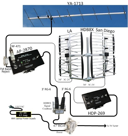

A compelling advertised feature of the HDB8X is its ability to align the 4-Bay panels to receive broadcasts originating from different directions. Since I predominately watch UHF stations coming from San Diego @ ~169 deg. (True) and Los Angeles @~292 deg. (292 – 169 = 123 deg.) I thought I would see how well it performed when configured with the panels orientated at a 123 deg. angle.
Similar to what I did yesterday, using the rotor, I “bump” aligned the CM-4228 for maximum SNR on San Diego channel 30 (15.1 KPBS) and then, by eyeball, “fix” aligned the non-movable HDB8X panel to match. I then “bump” aligned the CM-4228 for maximum SNR on LA channel 36 (4.1 KNBC) and then, by eyeball, “fix” aligned the movable HDB8X panel to match.
FYI, I had to tighten the wing nuts on the mast clamps until they were vertical to align the movable panel. To go more than ~130 deg. you’ll probably have to shorten the mast clamp bolts on the moveable panel side.
While I got my normal 3 San Diego UHF stations, I thought I had a bad panel pointing towards LA. Other than my local channel 26 (24.1 PBS TVFool @ -15.6) I couldn’t receive any LA stations. After several trips to the roof to check connections & alignment I decided to disconnect the LA panel from the combiner and use it like a standalone 4-Bay. I connected the combiner end of the HDB8X harness through an F-81 F-F barrel to the black coax used for testing yesterday. Configured standalone, I got channel 38 (30.1 ION) with an SNR in the 15.x range. Usually anything below 16.x isn’t watchable for very long. Clearly to be useable I was going to have to add an amplifier.
I connected the combiner end of the HDB8X harness through an F-81 F-F barrel to a 15’ section of RG-6 coax. I connected this new length of coax through a Channel Plus NF-471 55dB channel 24-29 notch filter to my Winegard AP-2870 amplifier’s UHF input. Configured this way I got 13 of the 19 channels I had yesterday. As expected, I lost the San Diego channels and all but one (PBS) of those in the NF-471 notch.
Pleased with the amplified single panel results, I reconnected the HDB8X harness to its combiner input and connected the 15’ section of RG-6 coax to the combiner output.
http://www.digitalhome.ca/forum/pict...pictureid=7010
Combining the two antennas resulted in the total loss of 9 LA stations and dramatically reduced the others. Based on today’s testing results, for my location, the HDB8X is a competitive 8-Bay Bow Tie when used in its “flat panel” configuration but is nearly useless for leveraging its advertised multi-direction feature.
http://forum.tvfool.com/attachment.p...0&d=1372563023
I suppose one advantage it still has over a conventional 8-Bay like my CM-4228 would be the ability to use it as 2 separate 4-Bays and run separate cables to a coaxial switch?
I also ran a series of tests substituting a PCT MA2-M +15 dB cable drop amp for the Winegard AP-2870. The Channel Plus NF-471 notch filter was not used with the MA2-M.
tripelo 10-Jun-2013 4:53 PM
Loss of Gain of S/N, Combining Two Antenna
Combining the two antennas resulted in the total loss of 9 LA stations and dramatically reduced the others. ...nearly useless for leveraging its advertised multi-direction feature.
Thanks Pete, for testing this feature. I’m sure that you know this:
There are at least three fundamentally different ways of combining all channels from two antennas. Each involves two or more significant sources of S/N loss.
In all cases, if the antennas point in different directions there is:
- Loss of the stacking gain (up to ~ 3 dB) that the antennas might have (assuming transmission lines matched).
Additional Loss for Each Case:
Case 1. Separate antennas pointing different directions connected to a hybrid combiner (usual splitter reversed) have:
- Loss through the combiner, typically more than 3.5 dB at UHF
Note: When the signals at the combined (input) ports are non-identical, hybrid combiners have 3 dB additional loss above normal circuit losses. Not-identical signals occur when antennas point toward differing stations.
Case 2. If the signals are combined with transmission line techniques that avoid the 3 dB hybrid combiner additional loss, then there is no isolation between input ports.
Without the isolation; The second antenna loads the first, and re-radiates away ~3dB of signal, vice-versa for the first antenna loading the second one.
Case 3. If both antennas have their separate matching preamplifiers prior to combining, then there is isolation between input ports, so:
* No loss thru re-radiation,
* No S/N loss through combiner (single signal input to output)
This is because both signal and noise have been raised above noise floor by preamplifier, so combiner loss in effect just lowers gain of both signal and noise. Not affecting S/N ratio.
But, now there is:
- Twice the noise, compared to one antenna, one preamp, and no combiner.
This is a result of each preamp adding equal noise power above noise floor. Two independent noise sources adds at combiner output.
Depending on preamp noise figure, this Case 3 could be better, or much worse than the first two cases.
Choose your poison.
Each method has some advantages and disadvantages.
Note: Matching two transmission lines is most important when antennas face same direction. When antennas face different directions, phase control of the two signals is usually lost, therefore matching transmission lines typically does not provide gain.
Note: Further in this thread is attempt to add more detail.
Diplexers such as a UVSJ, or a Join-tenna, get around some of the S/N losses mentioned in Cases 1 thru 3 by providing lower-loss frequency dependent isolation.
I suppose one advantage it still has over a conventional 8-Bay ... use it as 2 separate 4-Bays and run separate cables to a coaxial switch?
Yes.

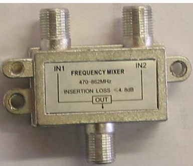

When I assembled the antenna, I noticed that the coax was unusually thin and very flexible with rubber boots and molded connectors installed @ each end.
Yesterday, I decided to document the coax harness and test it and the supplied combiner (by substitution). Fortunately, the coax was marked as 3C-2V, which made looking up its specs. relative easy. It is just another form of 75 ohm coax.
http://forum.tvfool.com/attachment.p...7&d=1371494504
I was surprised to find a ¼” difference in length when measured from screw-on edge to screw-on edge. First, I substituted two length matched 36” pieces of RG-6 between each of the HDB-8X’s BALUN's to the combiner. Worst case loss for 34” of 3C-2V@ 700 MHz = ~.268 dB and should be insignificant compared to RG-6 @ .217 dB. Needless to say, this test didn’t yield any noticeable difference. Next, I left the RG-6 connected to the BALUN’s and substituted an ordinary 1 GHz 2-way splitter for the combiner. Again, no noticeable difference in SNR.

I also recently purchased this antenna (HDB8X). I have used the 4228 for a few years and my situation is more difficult than most, 70 miles from the transmitters and in hilly terrain.
Construction of the antenna was straight forward, but I also found it to be weak in physical strength, the reflector end caps came off easily. I was also surprised that the elements were strickly pressure points between wires with screws and plates (no rivets or welds). Here in the Northwest, exposed to allot of water, these points will oxidize and become resistive over time (have already seen this design and used it, with the oxidation results) I doubt this antenna will with stand a 50mph wind (get them in the fall and spring).
Putting the 4228 against the HDB8X with a 10Db (2.7DB NF) amp (have too), the 4228 out performed the HDB8X by about 6Db (measured, I have a RFM 151)
I substituted the cheap combiner with a transformer type and picked up 3Db, but with the 300 ohm to 75 ohm baluns on each bay (HDB8X), it just couldn't match the performance of the 4228.
If I was closer to the transmitters by even 15 miles, and they were in different directions, this antenna would rock, but for fringe, (extreme fringe) it just wont hold up. As a side note the 4228 stand alone is weak also, for me, I must use the preamp, and to bring in a couple of weak stations I have doubled the 4228's (use two of them) into the preamp, allot of plumbing but it works. I did run a test with 2 HDB8X's (yes I bought 2, I had high hopes) into the same situation, and only received half as many channels. Those supplied combiners really bite. (HDB8X)
My next try will be to modify the HDB8X's with 300 ohm combiners (feedline method) and see what happens.
329049 11-Jun-2013 6:17 PM
1 Attachment(s)

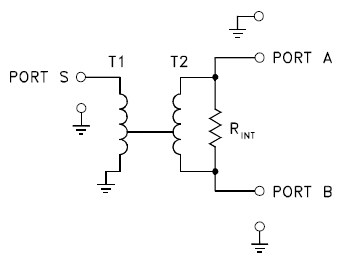

I got curious on the combiner. Wow, super cheap, only a 1/2 turn for each leg, good ones will have a min of 2 turns, up to 4 typically. Measured the loss, 4.9Dbm, ouch (before I took it apart)

Based on earlier posts and posts in other forums, I thought the DIGIWAVE ANT-7288 and Solid Signal antennas were the same. After looking at your pictures it appears they are not. What I bought was a “Solid Signal Xtreme Signal HDB8X High Definition Blade 8 Bay Xtreme Antenna (HDB8X)” for $59.99 with $0.05 shipping.”
While very similar at a glance, it appears our two antennas have completely different elements and mounting frames. Your elements appear to be made from wire, similar to my CM-4228 while mine are made from much wider 1.66 mm (~0.065”) thick stamped, or die-cut, 8” lengths of sheet aluminum. Please look at post #22 above for a better comparison. This may explain why our CM-4228 comparisons yielded such different results?
The picture you posted of the combiner you opened got me thinking that it might pass power through both ports. I just got down from the roof, after pulling mine off the cross brace. I show open from the case (ground) to all of the center conductors and continuity between all three center conductors. Not knowing this, I ran separate (different length) powered coax’s to each amplifier and combined their outputs in the garage. Later today, I’ll rewire taking advantage of the power passing this style combiner affords. Thanks for sharing that picture.
My combiner is labeled “FREQUENCY MIXER, 470-862 MHz, INSERTION LOSS less than or equal to 4.8 dB”. If accurate, that seems like an excessive amount of loss to incur for combining two 4-Bay outputs, especially in a flat panel configuration, but might explain why you saw so much improvement when you substituted a different type of transformer combiner?
At least if I can amplify each panels signal pick-up before it reaches the combiner it should help compensate for that 4.8 dB of loss.

tripelo 16-Jun-2013 6:46 PM
Combiner Effect - Signal & Noise (above kTB)
1 Attachment(s)
Referring to hybrid combiner in earlier post:
A hybrid splitter/combiner schematic may look something like this schematic from Mini-Circuits.
- Ports A & B are splitter outputs or combiner inputs.
- Port S is the combined port.
http://forum.tvfool.com/attachment.p...3&d=1371404556
It seems that most common splitters available are not configured as above. To find a splitter with good isolation between ports, it's probably best to look for a splitter with specified isolation. An isolation value between input ports of 30 dB is good number.
Attempting to add clarification to Case 3 in the previous post. Both the TV signals and the noise, being independent, suffer ~3 dB attenuation from one input port to output, or combined port, of the hybrid combiner. This ~3dB loss results from internal circuitry to provide isolation. There are also additional normal circuit losses that ranges from tenths of a dB to a few dB.
Noise power from two independent sources above the noise floor (kTB) is additive in a hybrid combiner. Equal noise power above noise floor at each input adds at output. So relative to signal power, the noise experiences no loss (3 dB loss through single port, plus 3 dB combined gain). The signal has no combined gain since the other input port does not contain that particular signal.
About Noise floor & kTB:
Because of the preamplifier’s gain, the noise power at combiner inputs is above the noise floor.
KTB, thermal background noise is a major contributor to the noise floor at UHF and above. Man-made and galactic noise can contribute to the overall noise floor but mostly these affect VHF more than UHF.
The overall result is that S/N is reduced 3 dB (hence the twice the noise mentioned in the previous post). Different signal frequencies from the separate antennas pointed in different directions do not coherently add in the combiner. Combiner circuit losses affect both the signal and the noise so this is where the gain of the preamplifier in front of the combiner can help with improved signal to noise ratio.
Assuming all three cases utilize identical preamplifiers, with preamplifiers after combiner in Case 1 & 2, then:
In general compared to single antenna, single preamp, and no combiner, all 3 cases lose S/N at combiner output (by about 3 dB plus).
Case 3 differs:
- Mitigates 2nd antenna loading losses (Case 2) and
- Via gain of preamplifiers, overcomes the additional normal circuit losses in the combiner (Case 1). Although they exist, no transmission line losses are assumed in Case 2.
- The noise figure of two preamps must low enough, so as to be a small contributor to final S/N, else Case 3 could make situation worse.
As the example in the previous post, All cases have interesting specific applications in which they may have some advantage.
Will make a small edit to Case 3 in earlier post to help with clarification.

Pete Higgins 21-Jun-2013 7:48 PM
HDB8X multi-directional config.
2 Attachment(s)
tripelo & all,
A gentleman on the digital home forum (holl_ands) identified the combiner picture that 329049 posted as a “Magic Tee” and posted several links for me to bone up on Magic Tee theory & design. 329049’s would basically be the T2 portion of the Mini-Circuits diagram that you posted and appears to be missing the port-to-port (2 X R) 150 ohm mis-match dissipation resistor (RINT). According to what I read, the 75 ohms on each input port should transform to 37.5 ohms @ the combiner’s output, necessitating the output impedance matching auto transformer T1 (also missing from 329049’s combiner). The only way I could tell if my model has a resistor across the windings would be to de-solder the metal cover, since a 150 ohm resistor in parallel with a couple of inches of wire is going to appear as a short to an ohm meter. Based on my continuity measurements, I can tell that mine doesn’t have a grounded auto transformer on the output side but maybe if I’m lucky its designed something like this:
http://forum.tvfool.com/attachment.p...1&d=1371843139
I wanted to show how I have the HDB8X configured for multi-directional reception. At my location, I really need the extra gain of an 8-Bay vs. a 4-Bay but when the signals aren’t faded this configuration seems to work very well –without a rotor. When the signals are faded, even my CM-4228 & amplified 91XG tend to drop in & out.
As you can see from my TV Fool report, KVCR, RF channel 26 @ -15.6 dBm (and an FM station on 99.9 @ -13.4) would severely overload my pre-amps., but all the rest of my San Diego (~168 deg.) and LA (~292 deg.) stations are 1 & 2 edge @ -85 dBm and below. That’s why I added the 55 dB NF-471 notch filter that rejects off-air UHF TV channels 24 to 29 and the Antennas Direct 20 dB FM Band reject filter to the AP-2870 LA panel amp.
http://www.highdefforum.com/members/...ti-setup-3.jpg
[IMG]http://forum.tvfool.com/attachment.p...1&d=1371843183[/IMG]
A couple of things to note are that:
1. I am powering both amps. through the two panel signal combiner that came with the HDB8X.
2. The NF-471 completely removes RF channel 26 @ -15.6 dBm with the LA panel pointed right at that station and the amplified & unfiltered San Diego panel that’s rotated ~123 deg. is also completely rejecting KVCR. I wasn’t expecting this. This panel does bring in RF channel 30 (KPBS @ -96.3 dBm) from San Diego with an SNR in the mid 20’s.

HDB8X Frequency Mixer
2 Attachment(s)
329049,
I wanted to let you know that while they still could be electrically equivalent, the HDB8X “Frequency Mixer” and the combiner that came with your antenna are physically housed in different cases. This at the least suggests they are supplied by different manufactures.
http://forum.tvfool.com/attachment.p...4&d=1372114840
http://forum.tvfool.com/attachment.p...1&d=1372114857

Pete Higgins 30-Jun-2013 1:21 AM
HDB8X multi-direction progress update
2 Attachment(s)
tripelo & all,
I wanted to update my progress to show how I had the HDB8X configured for multi-directional reception. For some reason, I haven’t been able to connect to the TV Fool or FM Fool sites for the last several days. (“the site TV Fool is not responding”)
At my location, I really needed the extra gain of an 8-Bay vs. a 4-Bay, but when the signals aren’t faded this configuration seemed to work very well –without a rotor. When they are, even my CM-4228 & 91XG tend to drop in & out.
http://forum.tvfool.com/attachment.p...1&d=1372554970
A couple of things worth noting are:
2. The NF-471 completely removes RF channel 26 @ -15.6 dBm with the LA panel pointed right at it and the amplified & unfiltered San Diego panel that’s rotated ~123 deg. is also completely rejecting KVCR. I wasn’t expecting this. This panel does bring in RF channel 30 (KPBS @ -96.3 dBm) from San Diego with an SNR in the mid 20’s, so it obviously has good forward gain near channel 26 and very good rejection of it to the rear.
As you can see from my TV Fool report, RF channel 26, 294 deg.@ -15.6 dBm (plus I also have an FM station on 99.9 MHz also @ 294 deg. & -13.4 dBm) would severely overload my pre-amps., but all the rest of my San Diego (~168 deg.) and LA (~292 deg.) stations are 1 & 2 edge @ -85 dBm and below. That’s why I added the Channel Plus NF-471 notch filter that rejects off-air UHF TV channels 24 to 29 and the Antennas Direct FM Band reject filter to the AP-2870 LA panel amp.
Subsequent to the single HDB8X multi-direction experiments, I decided to try the CM-4228 in conjunction with the HDB8X. My reasoning being that the theoretical 3 dB of additional gain (~ doubling the signal power) would help compensate during the signal fades that always seem to interrupt the San Diego evening news.
Because it was the only device I’d found that would pass power to both amplifiers from a single coax, I queried Solid Signal about purchasing an additional HDB8X Frequency Mixer. They currently don’t list them for sale, but generously offered to send me one (@ no cost) from an antenna damaged in shipping.
I wanted to reconfigure the test installation to raise the HDB8X above the rotor to the same height as the CM-4228 so I could align its pattern for best SNR but unfortunately I can’t bring down my pushup mast by myself. When originally implemented I had two sons, a teenager and a college student, living at home to help. Now, one lives in Oregon and the other retired last year and lives 60+ miles away. Undaunted, I revamped the test configuration as shown below:
As with previous testing, I “bump aligned” the CM-4228 for best SNR on LA RF channel 36 (4.1 KNBC @ -107.4) and using its alignment as a guide, aligned the HDB8X as close as possible to the same direction. (This makes the assumption that as mounted, both antennas have the same radiation pattern –which may or may not be valid.)
After everything was in place & hooked up, with both antennas pointed towards LA, I measured an SNR of 24.7-25.3 for RF channel 36 (4.1 NBC). I also measured a SNR of 30 (as high as my meter registers) for RF channel 26 (24.1 KVCR) the -15.6 dBm PBS station 3.5 miles from my house and in line with all the LA stations.
Next, I rotated the CM-4228 towards San Diego, stopping @ ~168 deg. As the CM-4228 turned I noticed 2-3 dB fluctuations in SNR. I “bump aligned” the CM-4228 for best SNR on San Diego RF channel 40 (39.1 KNSD @ -95.2 dBm). I went back and measured an SNR of 23.1-23.4 for RF channel 36 (4.1 NBC). Interestingly, having both 8-Bays pointing the same direction added an additional 1.6-1.9 dB to the SNR. As with previous testing, with the CM-4228 8-Bay turned 123 deg. away from my local PBS station, it didn’t show any back lobe response. Unfortunately LA RF channel 31 (5.1 CW @ -103.5) falls within the Channel Plus NF-471 notch filter’s skirt and was lost. (Rotating the CM-4228/HDP-269 back towards LA brings channel 31 back without any signs of overload)
UHF signal-to-noise ratios from both LA & San Diego are usually 20 dB or greater and appear to stay about the same as a single 8-Bay when aligned with a rotor. More importantly, with a sample size of three afternoons, my San Diego news station dips from an SNR of ~25 to a low of ~18-19 in late afternoon to early evening. It had been dropping into the low 15.x’s where signal was lost. Most nights it holds the 18-19 and stays error free, climbing back up after sundown.
With my limited evaluation capability, last summer my new 91XG performed only slightly better than my “original” CM-4228. This spring my new HDB8X, similarly, performed slightly better than my “original” CM-4228. Therefore, I have to conclude that for my location there isn’t a significant performance difference between the three designs. It also suggests that the advertised gain is very optimistically over stated. Unlike long Yagi’s or LPA’s, Bow Tie designs are easily mounted to a tower leg or off the side of a house or balcony (J-Pole). Hinged designs, also afford convenient reception of multiple markets where a 4-Bay is sufficient.
Because of their price and observed performance, if I needed to design a system from scratch to feed UHF to multiple TV’s without the inconvenience of turning a rotor to view different markets, depending on TV Fool’s reported values, I’d be real tempted to try an unamplified HDB8X with the panels aligned for both markets. If signals were such that you couldn’t tolerate the “re-radiation loss” I’d order two HDP-269’s to help isolate the panels and overcome combiner, coax & splitter loss. Finally, if signals are really weak, (deep fringe) combining two HDB8X’s with two matched pre-amps. (HDP-269’s in an overload prone environment) might offer a cost effective solution. I did find this Splitter/Combiner which should support powering two pre-amps. through a single coax. lead-in:
http://www.solidsignal.com/pview.asp...ce=google_base
SNR and antenna gain are not the same thing. I would really like to see gain comparisons and real world test results between the HDB8X that I have and some of the other hinged designs –some costing almost 4 times as much.
