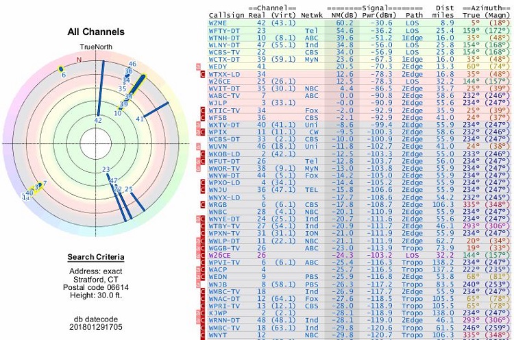

2 Attachment(s)
This is an image of your report:
https://forum.tvfool.com/attachment....9&d=1566758111

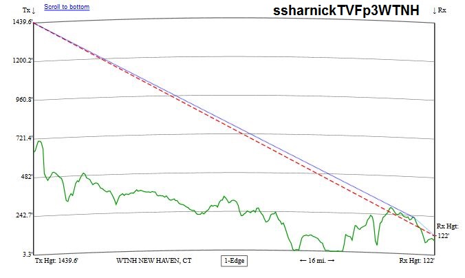

If you click on the Transmitter Distances in the rabbitears.info report, you will see terrain profiles that show you are indeed in a hole, which makes reception more difficult.
https://forum.tvfool.com/attachment....1&d=1566760545
WVIT NBC:
https://forum.tvfool.com/attachment....2&d=1566762125

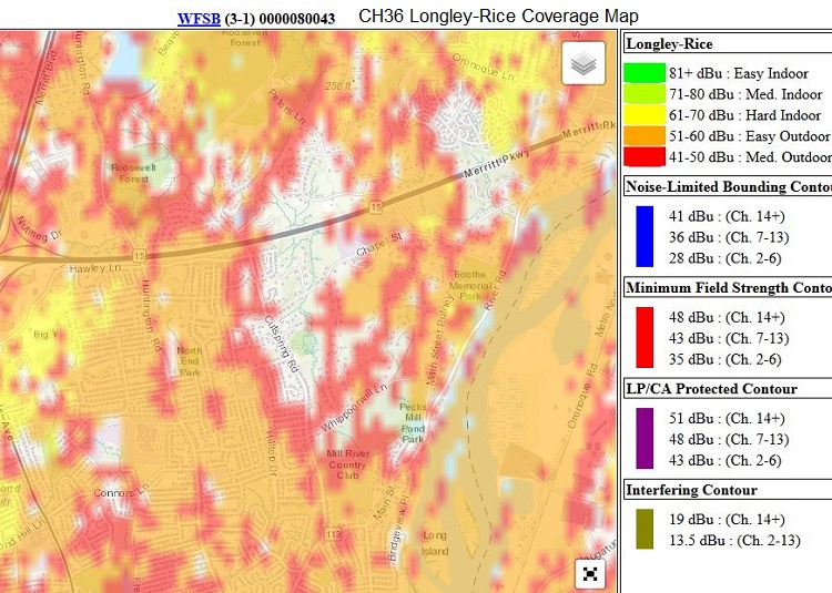

WFSB will be more difficult:
https://forum.tvfool.com/attachment....3&d=1566763550
Using other software for the WFSB terrain profile:
https://forum.tvfool.com/attachment....5&d=1566774694
This is the WFSB Longley-Rice coverage map for your area. Red is the weakest listed color; no color is weaker.
https://forum.tvfool.com/attachment....4&d=1566772378

I studied your map and when you said " I m living in a hole" I believe is around Cutsprings Rd, I used to live around John Chanda Park Huntington Rd and Wigwam Ln Rd. The wife and I retired from Sirkorsky Aircraft in 2015, sold and moved to NC. Although the salaries are not so good here, we have a big house and yard. I dont miss CT, taxes are ridiculous...can't retire up there.
ssharnick 21-Sep-2019 2:16 PM
You're correct tuffones. Cutspring!! Funny you mention Sikorsky. I was at bic for 22 years and was laid off last march and got a job at Sikorsky and will be celebrating my 1 year anniversary there in a couple of days! Wish I went there years ago for the benefits, but can't change that. Connecticut is getting worse and worse...more new taxes going into effect on Oct. 1st. Enjoy your retirement in NC!!!
