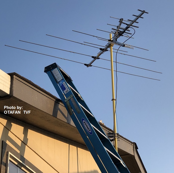

OTAFAN 1-Jun-2019 11:22 PM
Distance Between Antennas
OK, after reading everyone's post above again and further written research along with advise from some of my radio Buds locally, I climbed back on my roof Memorial Weekend and put up a Winegard HD7000R below my existing RCA ANT3037X(R). (jrgagne99 posted he also was climbing up on his neighbors borrowed 60' lift to adjust his antenna in the tree(s) Memorial Weekend as well. I'll be interested to see how he came out too).
It seems that when it comes to receiving antennas, distance between them is not as critical as with transmitting ones. That opinion was prominent in all the literature I read. So, after some experimenting and scanning my TV for signal strength and checking for interference on my other TV, I finally found that even 1ft below my RCA 3037 gave me optimal performance. And my Winegard 7000 is about 19 feet in the air above area rooftops and foliage. To repeat, no interference between my two TVs has been viewed! (If I'm missing something, you good Techs here tell me what I need to look out for going forward, please. Thanks!)
I have tried repeatedly to attach a photo to this post so you could see how my set up now looks, but to no avail. No matter what I do, my photo lays on its side at about a 240 degree angle. I've tried flipping the photo every which way but loose, but no luck. I've had some minor issues lately posting on TV Fool, so maybe the site is having some technical issues. If this issue resolves itself, I'll post the pic. (If anyone has advise here, please chime in, thanks!)
In the meantime, try to imagine a Winegard 7000 tucked 1ft neatly below and in parallel with its bigger brother the RCA 3037. So far, my project has exceeded my expectations.
Thanks to all you good folks here at TV Fool for your help!
rabbit73 2-Jun-2019 1:37 AM
Originally Posted by OTAFAN (Post 61681)
.....I climbed back on my roof Memorial Weekend and put up a Winegard HD7000R below my existing RCA ANT3037X(R).
.....I finally found that even 1ft below my RCA 3037 gave me optimal performance. And my Winegard 7000 is about 19 feet in the air above area rooftops and foliage. To repeat, no interference between my two TVs has been viewed! (If I'm missing something, you good Techs here tell me what I need to look out for going forward, please. Thanks!)
Glad to hear that you got good results. You did exactly the right thing: tried it to see how it works.
Post your photo as an attachment; maybe I can straighten it.
OTAFAN 2-Jun-2019 1:59 AM
1 Attachment(s)
So glad you replied, rabbit73! Hopes and prayers your wife and you are doing better.
I have been posting as attachment, including right now, but still not straight as previous pic in my original post on this thread.
Fingers crossed, you can work your magic rabbit!
Thanks again!
rabbit73 2-Jun-2019 3:40 AM
2 Attachment(s)
original photo, nice and sharp:
https://forum.tvfool.com/attachment....1&d=1559443929
Thanks for the second image.
Very odd. When I downloaded it with Firefox, it was vertical, but when I downloaded it with IE11, it was on its side.
I converted it to a jpg, made it vertical, enlarged it a little, and rotated it a little clockwise. I couldn't make it any sharper because your file size was very small.
Is that a different location, or just a different camera angle?
https://forum.tvfool.com/attachment....2&d=1559443058
OTAFAN 2-Jun-2019 4:51 AM
Same location, just a different angle. My new Winegard 7000 seemed to be more distinguishable from the side. And yes, I downsized the pic this time (probably too much) because of TV Fool site requirements I found out from posting my original pic.
A friend of the family suggested I try a different browser, but I did not have any issues with my original pic/browser, other than I had to downsize several times before TV Fool accepted the attachment. So, very odd indeed.
I'm still learning TV Fool's posting format and appreciate your patience and help, rabbit! But my learning curve is improving, certainly from when I first started several years ago now. Much due to your tutelage and others here!
A couple further observations after a week now with my new outdoor antenna setup.
The Winegard 7000 feeds 75' rg6 cable to my second Samsung 32" (2017 Best Buy Exclusive 1080p) TV, properly grounded, of course, by National Electrical Code parameters. Across UHF it matches or beats by a dB or two my main Living Room 40" Samsung TV (2013), which is fed by 90' of rg6 cable, again properly grounded. But on VHF the 40" has the edge and can "see" real channel 8, just over the "digital cliff," 16-17dB SNR. The Winegard does not pick up channel 8 at all. So, the RCA probably has more gain given its larger boom, especially for weak channels like 8. Interesting and puzzling. Also, my Channel Master 94444 balun leads on both antennas were cut to 2 1/2" each, according to rabbit73s' lab test. I found a couple dBs improvement!
Thanks again rabbit, you're the best.....

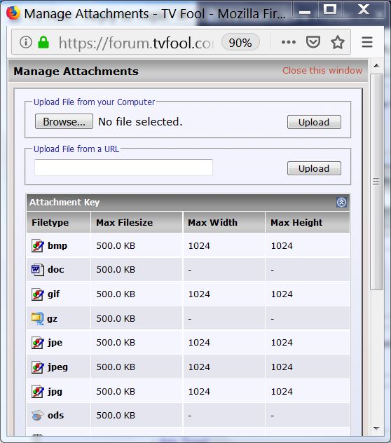

rabbit73 2-Jun-2019 7:45 PM
1 Attachment(s)
Originally Posted by OTAFAN (Post 61685)
I downsized the pic this time (probably too much) because of TV Fool site requirements I found out from posting my original pic.......I had to downsize several times before TV Fool accepted the attachment......I'm still learning TV Fool's posting format and appreciate your patience and help, rabbit!
These are the TVFool max attachment sizes for file size, pixel width, and pixel height. Anything larger will not be accepted as an attachment. I like to keep the width of jpg photos to no more than 750 pixels so that the posts don't get too wide. If the posts are too wide, the type in a post gets too small when trying to view the whole image.
https://forum.tvfool.com/attachment....4&d=1559500846
I crop and resize using a photo editor or Paint.

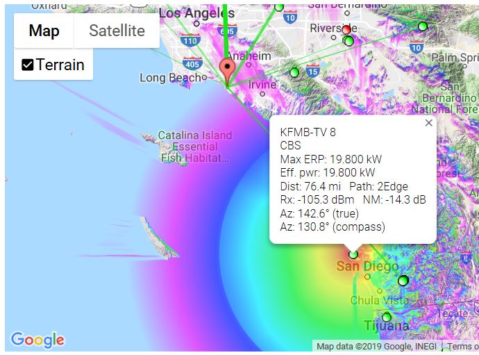

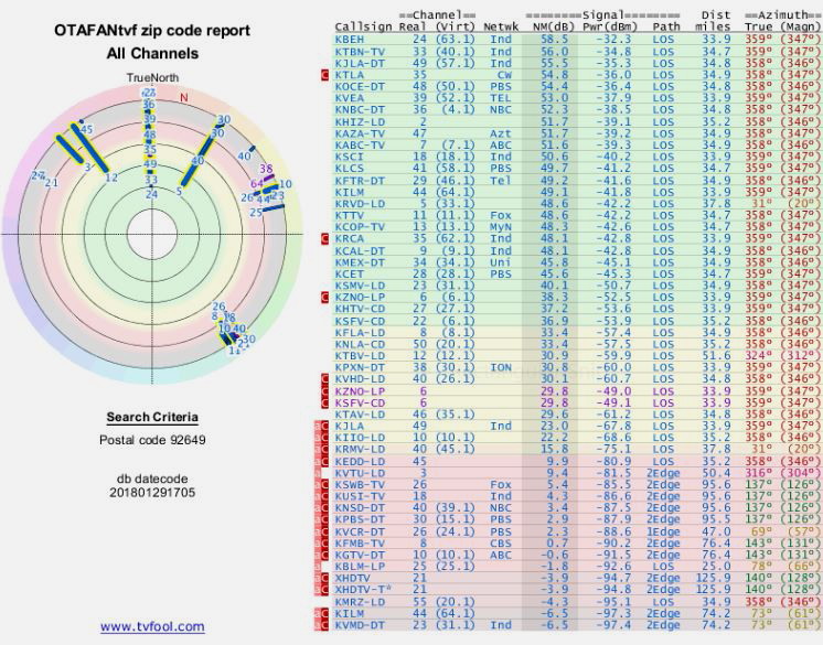

rabbit73 3-Jun-2019 1:36 AM
1 Attachment(s)
Originally Posted by OTAFAN (Post 61691)
I think rabbit73 hit it on the nail in above quote, though. Before I put up my Winegard 7000, I pointed my RCA 3037 a bit left and right of the recommended 346 degree magnitude for optimal reception at my location 35 miles south of Mt. Wilson. I found that when I pointed it towards LA proper, I could increase the signal strength on my living room 40" Samsung to around 19dB SNR from the current 16-17dB SNR. But I lost a few dBs from MeTV KAZA 54-1 (virtual) real channel 22. And since I watch a lot more of MeTV than channel 8's lineup, I deferred to approximately 346 magnitude. Also, it's common knowledge here in SOCAL LA/OC that channel 8 is a weak and "choppy" station, although there are a few viewers who seem to get fairly good reception. I spoke with the owner of channel 8 several years ago by email about said issues, and he said he was "hemmed in" by the FCC with low power so as not to interfere with border stations. I have little knowledge about what it takes to run a TV station, but my take on it was that it probably came down to economics and a business decision. After all, he is the owner. But for us viewers in TV Land, channel 8 viewing is problematic.
Um, you keep mentioning real channel 8, but I don't remember you giving a callsign for it. Is it KFLA-LD?
Does this look anything like your report?

OTAFAN 3-Jun-2019 2:01 AM
http://www.tvfool.com/?option=com_wr...90381088e7c829
I was just thinking about this rabbit and realized I probably should have included real channel 8 callsign, KFLA-LD. Thanks for reminding me!
And yes, that is my TV Fool report. I was looking at KFLA-LD real channel 8 at RabbitEars with the Longley-Rice map. It showed me again what I remembered about the reception in my area. Indeed, the "hot spot" is over LA and weakens as it permeates my area. So, my RCA 3037 confirmed the Longley-Rice map, or visa-versa. I probably would need an even larger antenna boom to improve reception. But at my age, what I have on my roof is my limit! LOL!
However, if you have any more suggestions, I'm all ears.....
Thank you.
Yes, KFLA-LD IS a low power station, but I don't consider it the fault of the FCC. Low power stations are supposed to run at low power, hence the name.
Not only is it running low power, but it has a very directional antenna that sends only 0.366 kW out of 3 kW ERP in your direction, That is 366 Watts out of 3,000 Watts:
http://www.tvfool.com/?option=com_wr...ALLTV%26n%3d26
https://www.rabbitears.info/tvq.php?...ms&facid=28566
Any suggestion that I can think of now would probably exceed your limit.
OTAFAN 3-Jun-2019 3:17 AM
If my memory serves me right, I believe KFLA-LD Channel 8's very directional antenna is what the owner was referring to when I contacted him several years ago by email. But he did say the FCC did not want any interference with border stations??? Again, memories are not often the best evidence in a court of law, but I would stand by my recollection today.
The main reason I was trying to receive KFLA-LD initially was they used to air RETRO TV. Now, that RETRO has moved to KWHY 22 (real channel 4) and will air June 15 according to their Facebook page, I replaced my other RCA 751 with my two new antenna's capable of receiving low VHF. KFLA-LD's line up is not a priority for me presently, especially since they continue to be low powered. I can watch Channel 8 most of the time when needed, but hopefully they will update their power with the FCC sometime in the future.
Anyway, if you're ever out here in SOCAL LA/OC rabbit, let me know and you can help an Old School Guy put a bigger antenna that will rival the best here on the West Coast! LOL!

https://forum.tvfool.com/attachment....7&d=1559606401
The problem is especially critical at the US-Canadian border. Many Canadian viewers want to receive US channels, but the US channels are very weak because of the directional antenna patterns. Repack has made the problem even worse because of increased co-channel and adjacent channel interference.
The worst location for a Canadian viewer is just North of his local transmitters. When he aims his antenna South for the weak US channels, his local channels overpower the US channels.
ADTech 4-Jun-2019 2:11 AM
This one has nothing to do with the agreements between the US and Mexico regarding non-interference.
For channel 8 in LA, the "problem" (for them) is that they are licensed as a "low power digital" stations that is required by the rules to not interfere with stations that are licensed as "full power" (or class A). In this case, San Diego station KFMB is the station that has an interference protected contour that KFLA is not allowed to interfere with.
rabbit73 4-Jun-2019 3:00 AM
1 Attachment(s)
Ah, so; KFMB in San Diego, also on 8.
Thank you for the clarification.
https://forum.tvfool.com/attachment....8&d=1559614361
