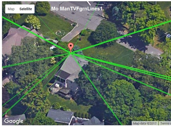

5 Attachment(s)
OK, thank you. I have removed the street name. If that isn't sufficient, I will delete if you say so.
http://forum.tvfool.com/attachment.p...1&d=1510857065
http://forum.tvfool.com/attachment.p...2&d=1510857086
http://forum.tvfool.com/attachment.p...1&d=1510857496
http://forum.tvfool.com/attachment.p...4&d=1510857156
http://forum.tvfool.com/attachment.p...5&d=1510859681

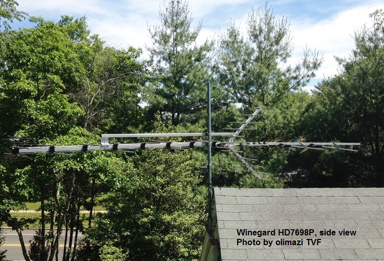

olimazi, who lives in Branchburg NJ, SW of your location, has a similar NYC terrain problem and trees. His antenna aimed directly at a tree also:
http://forum.tvfool.com/attachment.p...5&d=1498231828

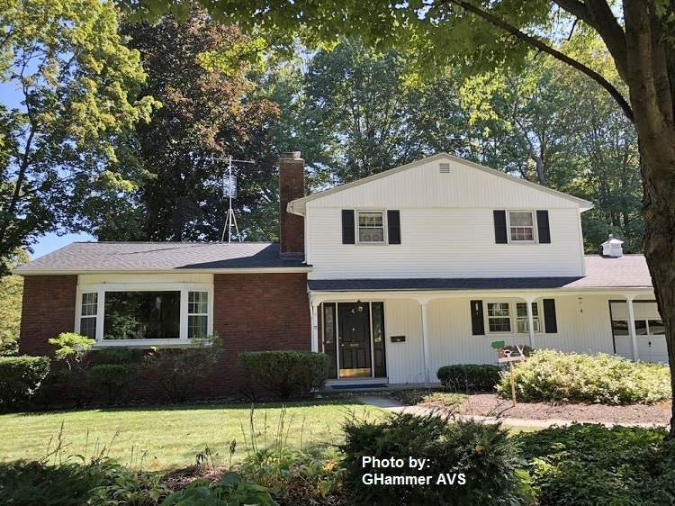

GHammer also had a problem with trees. He tried 3 locations on his roof. The first was above the garage on the right end. The second was on a tripod at the left end as shown above. IIRC, the best location was on the roof peak at the center.
http://forum.tvfool.com/attachment.p...6&d=1510874416
