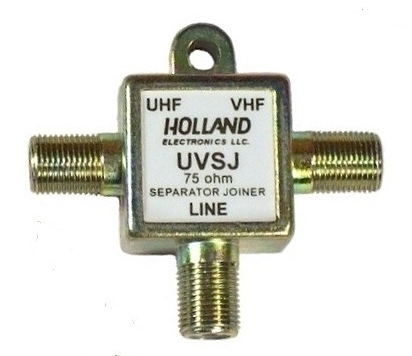

That is a suitable UHF/VHF combiner AKA UVSJ.
I'm thinking of going with tower guy's suggestion, but a little fuzzy on where to combine the signals. If it's up on the roof, will water be a problem?
The problem is with the preamp. You need the preamp for the weaker VHF signals from 342 degrees using your present antenna, but you must not use a preamp for your local strong signals from the UHF antenna. If you put the combiner outside between the antennas and the power inserter inside, then the combiner must be able to pass power to the VHF antenna preamp. But, that type of combiner is no longer available; only the ones that would pass power to a UHF antenna preamp, which you don't need.
That is why you need two coax lines coming down.

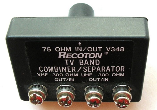

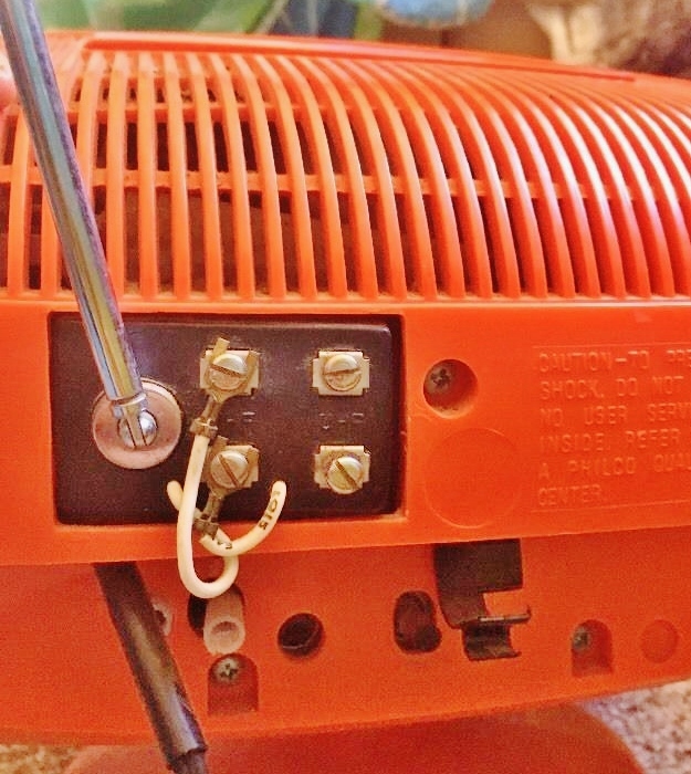

rabbit73 7-May-2017 2:22 PM
2 Attachment(s)
Originally Posted by Bigbear (Post 57916)
Yes. The last time I measured one, it performed well.
Thanks rabbit for the diagram. Now the only problem is finding a UVSJ. All the links I find lead to discontinued products.
They are getting hard to find. Solid Signal is out and mjsales.net is out. There are some on Amazon and ebay. Antennas Direct still has them:
https://www.antennasdirect.com/store...Combiners.html

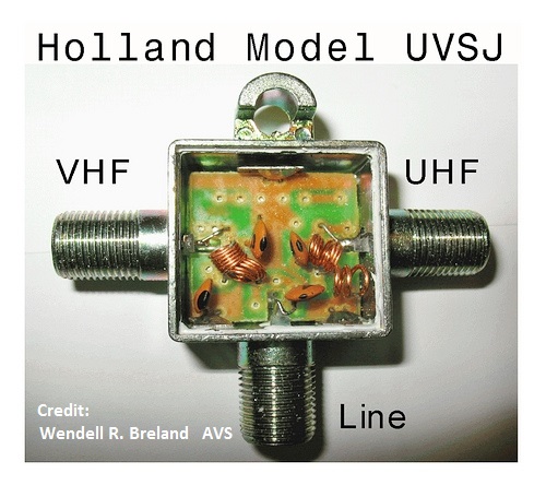

Inside the Antennas Direct UVSJ housing:
http://forum.tvfool.com/attachment.p...1&d=1494170120

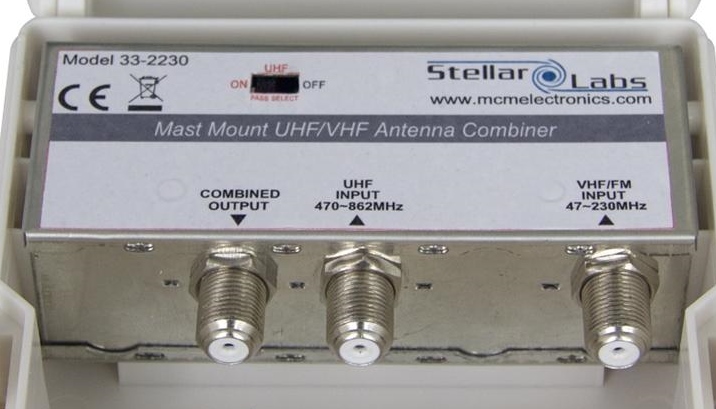

MCM also has one, but I have received mixed reports about its reliability. Maybe I'll have to order one and test it.
http://www.mcmelectronics.com/product/33-2230
http://forum.tvfool.com/attachment.p...1&d=1494251768

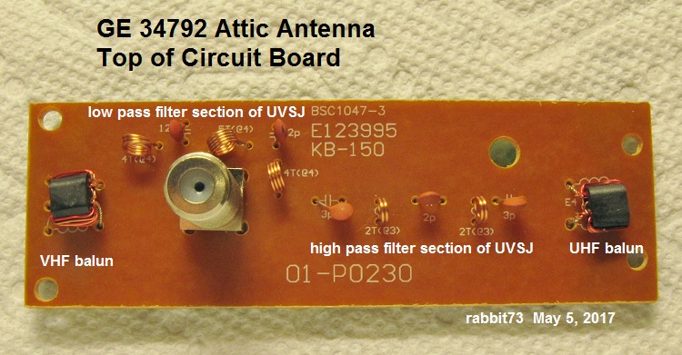

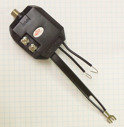

If it gets any worse, we will have to make one like in the GE 34792 Attic Antenna:
http://forum.tvfool.com/attachment.p...9&d=1494003888
http://forum.tvfool.com/attachment.p...0&d=1494003908
I have used the conventional terms for top and bottom of the board. The top is where the components are mounted and the bottom is where the ground plane is located. In actual use, the coax connector faces down.
The GE 34792 Attic Antenna includes a REAL UVSJ, not shorting stubs, to keep the UHF and VHF signals separated before combining. Each section of the antenna has its own balun. The UVSJ and the well designed reflector are responsible for the good performance of this antenna.

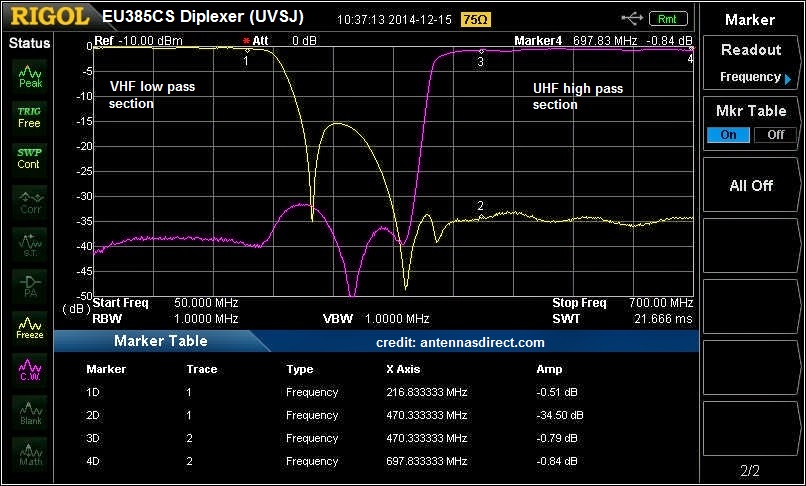

Here is a circuit of a UVSJ by SM0HX (amateur radio callsign for a ham in Sweden). The UVSJ UHF/VHF Separator-Joiner belongs to the filter family of Diplexers. All UVSJs are Diplexers, but not all Diplexers are UVSJs; Diplexer is the more general term. A HLSJ is also a Diplexer, but for VHF-Low and VHF-High.
http://forum.tvfool.com/attachment.p...1&d=1494003982
The UHF highpass filter section has 3 series capacitors and 2 shunt inductors. The VHF lowpass filter section has 3 series inductors and 2 shunt capacitors.
Here are the curves for the Radio Shack UVSJ:
http://forum.tvfool.com/attachment.p...2&d=1494007033

4 Attachment(s)
Many years ago TV sets had separate inputs for VHF and UHF. The UHF/VHF Separator Joiner was developed to separate the UHF and VHF signals coming from the antenna to feed the separate inputs for two tuners. There were also UVSJs that would combine two 300 ohm antennas for a 75 ohm input TV. Some TVs had two 2-screw 300 ohm inputs, and some had a 75 ohm coax input for VHF and a 2-screw input for UHF where you could mount a UHF loop.
Separate tuners for UHF and VHF. To tune to a UHF channel, you would set the VHF channel selector to U, and then rotate the UHF dial. The output of the UHF tuner was sent to the input of the VHF tuner:
http://forum.tvfool.com/attachment.p...1&d=1494355873
The 2 screws in the center are for VHF and have the internal antenna connected. The 2 screws on the right are for a UHF antenna:
http://forum.tvfool.com/attachment.p...1&d=1494356524
This UVSJ combines a UHF and a VHF antenna for a 75 ohm coax input TV:
This UVSJ separates the UHF and VHF signals from a 75 ohm all-band antenna for a TV with separate 300 ohm UHF and VHF inputs:
The common use these days is to combine a UHF antenna with a VHF antenna for the single input of current TVs, but the UVSJ is a reciprocal device that can be used to combine UHF and VHF signals OR separate UHF and VHF signals.

You are not off base, you are correct. If you can not find a UVSJ with power pass on the VHF side, you must use two coax down leads like this:

The Holland UVSJ passes DC to the VHF port, but there is no arrow:
http://forum.tvfool.com/attachment.p...1&d=1494470497
Notice that it says Separator so that it doesn't get confused with a splitter, as happened here on this thread, creating a heated discussion:

Inside:
