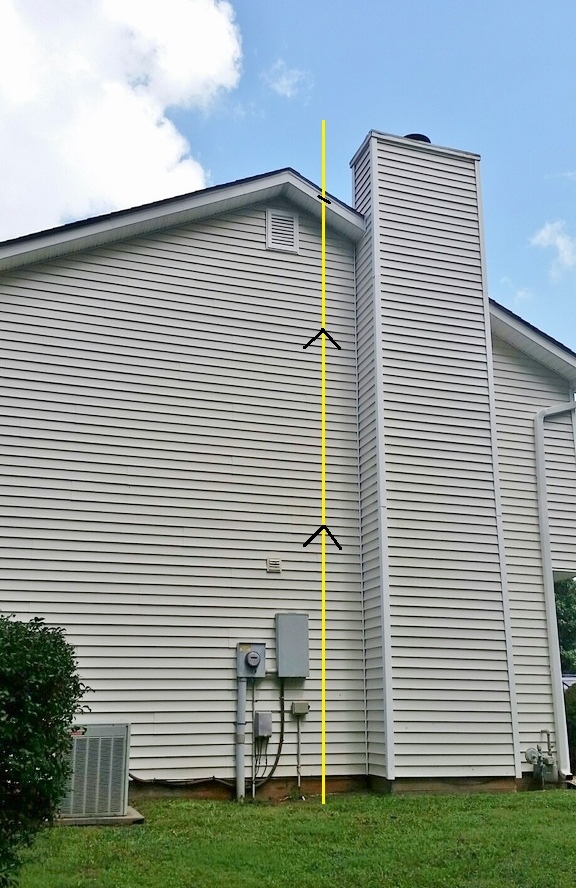

wado66 3-Sep-2016 5:18 PM
This is an actual picture of my home where I want to put the antenna just so you know what I am dealing with.
http://i183.photobucket.com/albums/x...05_resized.jpg
rabbit73 3-Sep-2016 6:53 PM
3 Attachment(s)
How about this?
http://forum.tvfool.com/attachment.p...1&d=1472928675
http://forum.tvfool.com/attachment.p...9&d=1441917363
bobsgarage 3-Sep-2016 7:13 PM
Originally Posted by rabbit73 (Post 56202)
That's what I was thinking. His house looks like new construction, the eave should be strong. As long as he can clear his utilities, it would be a clean installation.
He was talking about a brace coming from his chimney, so he could go fairly higher than the peak of the roof probably getting 35' AGL if the brace was done right.
bobsgarage 3-Sep-2016 7:48 PM
Masting advice
You can get the antenna up 30-42 feet AGL. So 2 21' sections of 1 5/8 or 1.66 as the hardware store calls it would get you up there I would use the thickest pipe available, or sleeve it -or both. Now you don't care what weighs because the load bearing is done by the ground hopefully on concrete with a folding base so you can tip it out. But that part, isn't necessary. The concrete part is important though.
And ground it.
Rabbit, who is the most helpful person and the most resourceful person on this and other forums gave you some great detailed photos. You are in good hands here !

rickbb 6-Sep-2016 5:45 PM
You won't be able to run the pole all the way into the ground due to the electrical panel being directly below the ridge line.
You could however use a chimney strap mount even though that's not a brick chimney it should still work.
Edit; unless that's vinyl siding, looks like it is. Scratch the chimney strap.

Got to checking my eaves and I do not have adequate support. Just 1X boards.
Having to rethink the whole process.
