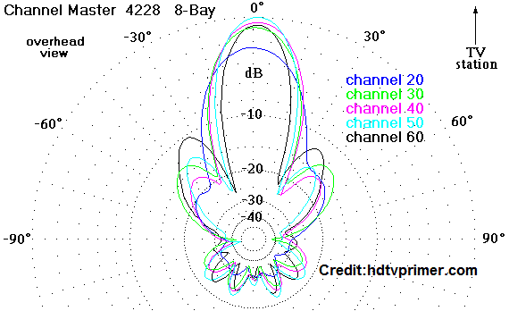

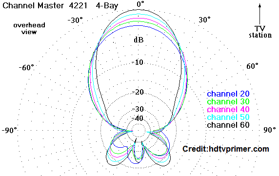

Really!?, I assumed that since channel master states the antenna has a 180 degree radius that it would be perfect for my situation. Guess maybe I was wrong to assume.
You weren't wrong, you are just the victim of "creative marketing." They are wrong with their claim:
Long range multi-directional (180-degree range) outdoor antenna up to 80 miles
The 4228HD, AKA EXTREMEtenna 80, is not multi-directional, it is VERY directional. Your hopes were raised by their inaccurate claims to sell antennas, only to have them crash down on the rocks of reality.
Originally Posted by Tigerbangs (Post 55950)
the bandwidth of the 4228HD is narrow enough to exclude signals that are that far off-axis.
He meant beamwidth, not bandwidth. The proper way to state beamwidth is between the half-power points, which are 3 dB down from max. The original Channel Master company would never make such a wild claim. PCT International bought out Channel Master, fired its best engineers, closed down the NC plant, and had antennas made overseas.
Their 180 degree claim just means it will receive signals from the front and not the back.
Winegard and Antennas Direct have more integrity, they state beamwidth and show antenna patterns of gain vs azimuth.
Here are the patterns of the original 4221 and 4228:
http://forum.tvfool.com/attachment.p...1&d=1471887301
You can see that the 4228 beamwidth is much more narrow, AND there is a null each side of center where the other direction (about 22 deg difference) falls to make the other signals much weaker.
You would have been better off getting the 4221HD or the Antennas Direct DB4e, and aiming between.

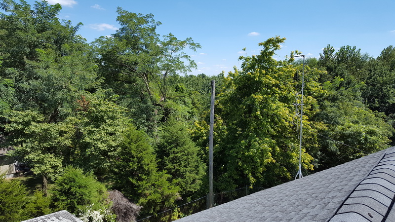

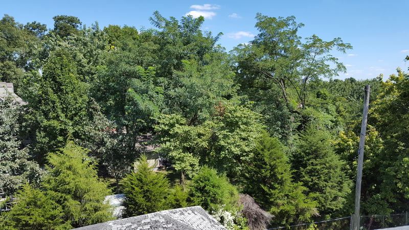

lviperz 23-Aug-2016 11:47 PM
1 Attachment(s)
Attached is a pic showing the direction the antenna is pointing. The antenna is about 30ish feet high. The trees are about 100 feet away.

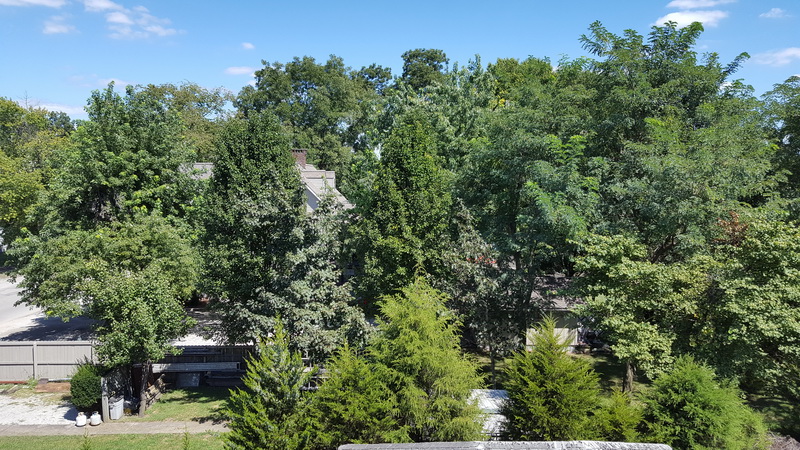

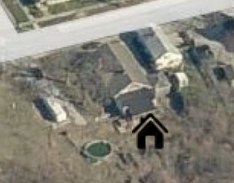

rabbit73 24-Aug-2016 3:54 PM
2 Attachment(s)
Thank you for the photo; it helps a lot.
http://forum.tvfool.com/attachment.p...5&d=1472050455
I was wondering about that wire. Is it a power line wire? If it is close to the antenna and you have a high level of power line noise, it might affect TV reception, but it is more likely to affect VHF (ABC) before it would affect UHF.
http://forum.tvfool.com/attachment.p...6&d=1472050615
lviperz 24-Aug-2016 3:59 PM

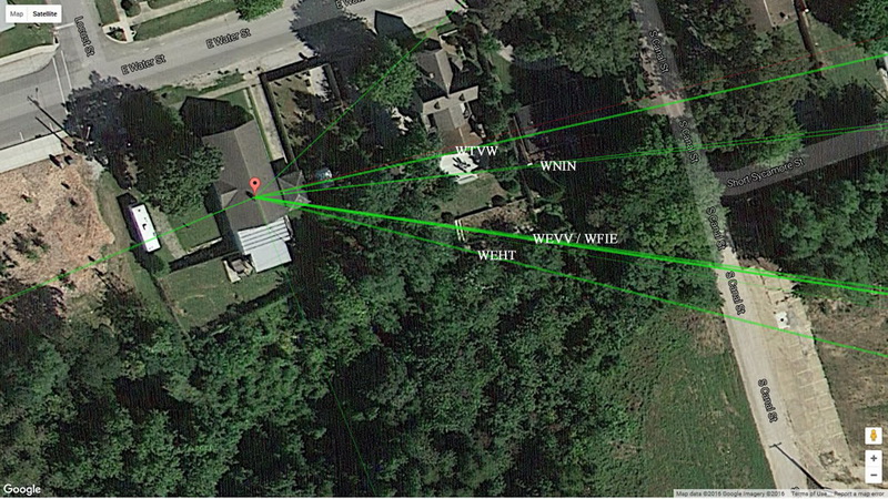

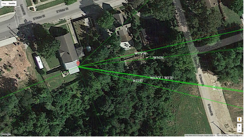

FYI. The small clearing just to the right of the antenna is WFIE, WEHT and WEVV. THe tree tops to the far left is WTVW.
rabbit73 24-Aug-2016 4:14 PM
Yes, that would make a difference in reception.
When you put the STEALTHtenna back up it had the beamwidth needed, but not enough gain for a location below the tree tops.
My other thought for improvement was to try a pre-amp but with the other channels so strong, I thought the pre-amp would actually hurt those signals.
Your thinking is correct. If you used a preamp, and if the antenna was in the clear, you would probably have tuner overload.
Forum member MikeBear had a similar problem with trees. When he raised his antenna above the trees, he lost reception of all channels. He thought his CM7777 preamp had gone bad, but it was just overloaded. He replaced it with a lower gain preamp and he was then OK.
http://forum.tvfool.com/showpost.php...6&postcount=45
lviperz 24-Aug-2016 4:28 PM
That is a powerline that went to a house next door. That house is gone and that powerline goes to a pole on the opposite side of my yard but is disconnected. There won't be another house there.
Yes, the stealthtenna picks up WFIE, WEVV and WEHT just fine. Using the HDHR tuners, those stations run at 85% or greater with 95% to 100% signal quality and symbol.
The problem is with WTVW which is to the left. It gets about 65% to 68% strength and drops out often. The antenna is aimed about 90 to 95 degrees, give or take a few degrees.
I thought about going higher, I do have another 10 foot tower section, but I would have to use some guy wire which I'm trying to avoid. No good place for the west guy wire. Plus it's already too close to the old powerlines. Right now if the tower fell in that direction it would barley clear the lines.
The other choice is moving the antenna to a chimney mount on the house. But the house is about 100 years old and has the old style rounded bricks. It's only about 3 feet from the ridge so maybe best I can do is a 10' pole, but probably safer with a 5' pole. That would put me at about 30' high also but maybe 30' further North.

lviperz 25-Aug-2016 8:13 PM
3 Attachment(s)
So here are the images from the interactive map showing the current location, possible chimney as well as the front of the house. All 3 show the lines indicating the path to the stations.
I still have to get on the roof to make sure I will clear the neighbors house. I have a story and a half, he has an actual 2 story house.
http://forum.tvfool.com/attachment.p...1&d=1472759764
Current location of antenna
If I mounted on the chimney
I don't really want this location. I don't really want to see the antenna from the front like that. Beside, how to get that past the wife with a 1 year old new roof would prove difficult.
rabbit73 26-Aug-2016 1:38 AM
1 Attachment(s)
Thanks for the interesting photos. Good analysis. You do have a lot of trees in your most needed direction. I don't see an easy solution. The antenna needs to be where the signals are, and the trees will continue to grow.
An Antennas Direct C2V might look a little better from the street. I wonder if it has enough gain if you can get it high enough.
(I try to limit the width of my photos to 800 pixels. Otherwise the post gets too wide and then the type is too small.)
Wish I had a better answer for you.

lviperz 3-Sep-2016 10:00 PM
View From Roof
3 Attachment(s)
So I finally got on the roof today. Not one of my favorite things to do anymore. Guess I lost some nerve as I aged. Anyway, here are 3 shots from the chimney. Height is about 30 feet. I took shots in the direction of WTVW, in between where the antenna would point and finally towards WFIE, WEVV and WEHT. So basically starting West then moving right towards the South.
http://forum.tvfool.com/attachment.p...1&d=1472935722
Looking towards WTVW
Looking towards where the antenna would point. Midway between the furthest stations.
Looking towards WFIE, WEVV and WEHT
The chimney on this old house only extends maybe 2 feet from the ridge. So the most height I could probably get is 5 foot off the ridge. So basically the height I took the pictures from.
Now comes the questions. First off I'm thinking the beamwidth of the stealthtenna I'm currently using isn't all that wide. So probably might do fine with the Winegard HD7694P at the current location. Thoughts?
My other question is about my tower. I have another 10 foot section I can add but I'm worried about needing guy wires. I currently have the tower strapped to the flat roof with 18" metal straps. THe tower is currently 4 feet above the roof. If I add another 10 foot section, would the current straps at about 15' be enough to stabilize the tower? Or should I use some guy wires?
I could easily run 2 guy wires to the east at the North and South ends of the roof. The other guy wire would have to go West and there is a utility pole there in my yard. No services on it any longer so I could anchor it there.
rabbit73 3-Sep-2016 11:49 PM
1 Attachment(s)
Thanks for the photos.
I feel the same way.
Huh? Starting East and moving South?
I think the beamwidth of the stealthtenna is at least as much as the 7694. There is an inverse relationship between gain and beamwidth. More beamwidth means less gain; more gain means less beamwidth.
Your photos show that you must go higher. You must not extend your mast without guy wires. A good solution, to keep ahead of the tree growth, would be a 5 or 10 ft tripod at the peak installed by a roofer to reduce the chances of leaks from roof penetration by fasteners. An alternative would be a Rohn 25G tower (expensive) somewhere on your property. Another alternative would be a tilt up mast to keep you off the roof or tower.
