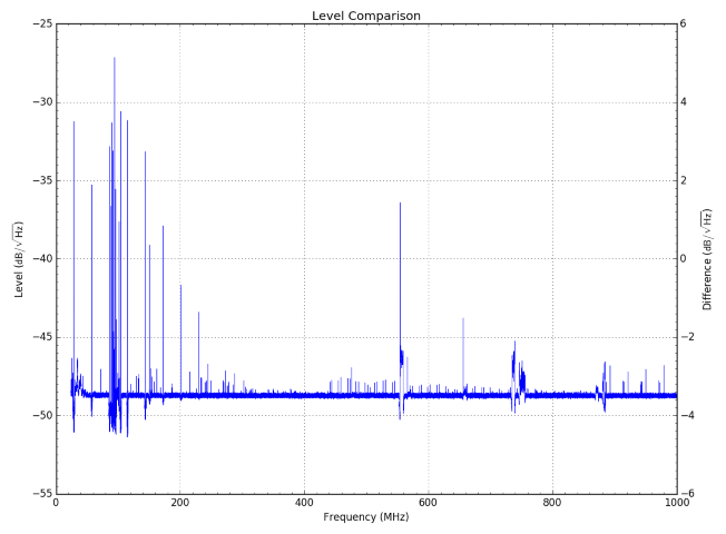

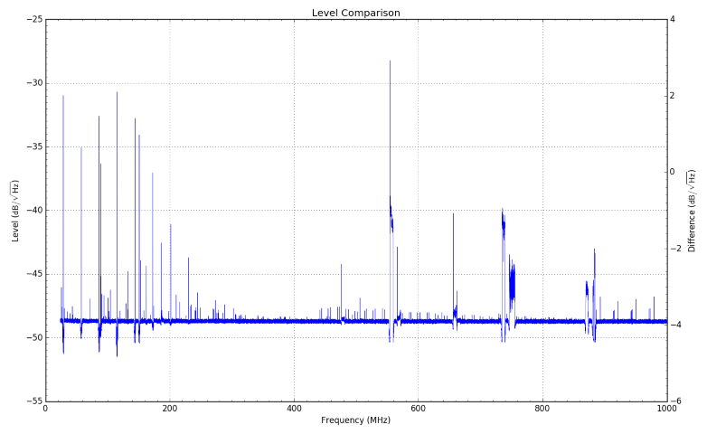

rabbit73 25-Apr-2016 8:04 PM
1 Attachment(s)
I favor the Channel Master 7777 for you. It is easily overloaded, but I don't see any very strong signals in your report that would do that.
I also did an FM signal report using your short coordinates. I don't see any FM signals strong enough to interfere with TV reception, and the 7777 has an FM filter.

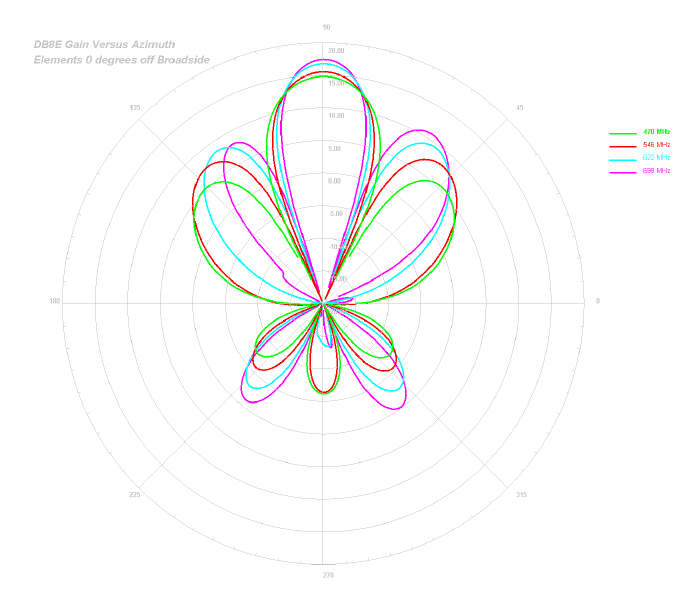

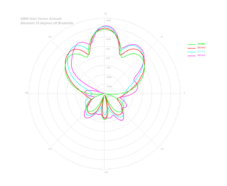

rabbit73 25-Apr-2016 8:34 PM
3 Attachment(s)
ADTech's conservative advice is also valid. The lower gain preamps, like the CM7778 and the AD Juice, have sufficient gain to cover distribution losses. Once the signals are amplified by the preamp, they are better protected from distribution losses. A 3 dB loss between the antenna and the preamp input can be 10x worse than a 3 dB loss after the preamp. So, keep the coax between the antenna and the preamp input short, because that loss directly subtracts from the antenna gain and increases the System Noise Figure. Here is an example of how much difference the placement of a 3 dB loss can make:
http://forum.tvfool.com/attachment.p...6&d=1461612830
http://forum.tvfool.com/attachment.p...7&d=1461612839
http://forum.tvfool.com/attachment.p...8&d=1461612848

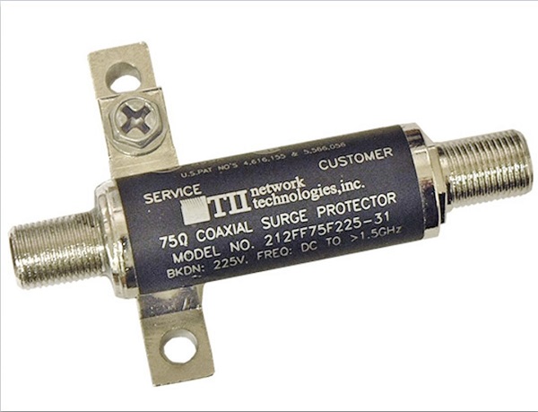

and an inline surge connector in the middle
Which surge connector? Is it still there?

Yeah, it's still there. I did pull it out when testing, and just put a coupling in there, no difference.
https://www.amazon.com/gp/product/B0...?ie=UTF8&psc=1
rabbit73 10-Nov-2016 9:27 PM
1 Attachment(s)
That is supposed to be a good one, but coax surge protectors have a device connected between the center conductor and the shield that is known to degrade weak signals. I only use a grounding block which just grounds the shield and meets the requirement of the NEC for an ADU (Antenna Discharge Unit), especially if it is a "Listed" device.

My Antenna layout and setup:
http://forum.tvfool.com/attachment.p...1&d=1485363646
Notice the panels/elements are off broadside about 10 degrees each, and should probably be closer to 15-20 each, but...
The spread for the DB8e @ 0 degrees:

The spread for the DB8e @ 15 degrees:
http://forum.tvfool.com/attachment.p...1&d=1485363697
I have 4 cell towers within 10 miles. Number one is only 1.2 miles away, but just north of us @ 6 degrees. Numbers 2, 3, and 4 are all in the 240-280 degree range.
As we've discussed before, I've always had trouble getting what I though I should with the DB8e. Last summer I disconnected one panel on the DB8e, bypassed the combiner, and effectively made a DB4e to test. I received more channels than I ever though I could. It worked great for a while, but when the leaves fell over the winter, I lost nearly all channels.
I recently connected the DB8e back up, as I thought it should be. The setup linked above is how it's currently configured, and Channel 7(28) will occasionally show up on the TV... nothing else. Assuming overpowering, and per the recommendation of this place & ADTech, I added a splitter between the pre-amp and the DB8e, knocking the input signal an additional 3db. Here is a 24-1000Mhz RTLSDR scan from that:
http://forum.tvfool.com/attachment.p...1&d=1485365553
So, I've effectively started over. I try to run two tests a night, lowering the tower to make tweaks. I've made scans prior to the surge protector, and although they show gains on a few channels, not enough to warrant the overall loss.
Based on the information above, what do you all think I should try next? Or, better yet, what tests would help identify the problem?

Two more scans tonite. The antenna direction and elevation did not change from the scan in my previous post above.
One, I completely removed the attenuation, preamp & injector from the mix, and took my scan at the same TV location connected straight to the RG11:
http://forum.tvfool.com/attachment.p...1&d=1485394200
Two, I kept the attenuation, preamp & injector removed, but replaced the surge protector with a grounding block/coupling, scan completed at the TV:
http://forum.tvfool.com/attachment.p...1&d=1485394202
The results were very close. The grounding block/coupling actually decreased the signal slightly. I'd say that's because my ground wasn't cleanly connected to the block... I noticed that after the scan.
