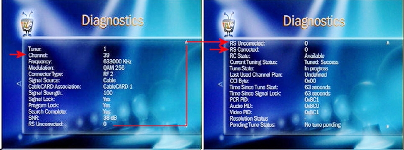

What make and model is your 60 inch plasma TV? Does it have a signal strength indicator?
I just took delivery of a new Tivo Roamio OTA
The Roamio should have a Diagnostics Screen that looks like this:
http://forum.tvfool.com/attachment.p...1&d=1431963937
I think it's here, IIRC:
From TiVo Central > Settings & Messages > Account & System Info > DVR Diagnostics
ADTech and I spent a lot of time (8 pages!) helping mulliganman with his Tivo Roamio. I thought his problem was multipath. Then I thought it was signals too strong. Then I thought it was multipath again because his C2V was in a poor location, which was correct. His TV and his CM DVR did a little better than his Roamio with the poor antenna location. I had him make some tests using the Diagnostics Screen to check signal strength, SNR, and Errors. He finally moved his antenna to a better location.

Image of Diagnostics Screen
http://forum.tvfool.com/showpost.php...0&postcount=49

killjoy 18-May-2015 8:30 PM
Panasonic Viera TC-P60VT60. It was the last generation before Panasonic exited the plasma business. I'd have a hard time getting coax to the TV directly since it's wall mounted with only HDMI between the DVR (soon to be the Tivo) and the TV run within the wall. But doable, if needed.
I honestly haven't taken it out of the box yet since I have no antennas to run it with. But I can fire it up soon to confirm.
