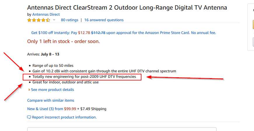

ADTech 26-Jun-2020 5:42 PM
1 Attachment(s)
Originally Posted by derf (Post 63005)
Thanks. I'll let you know.
It would be nice if the ad for the antenna was clear about what it works for and what it doesn't.
The product listing explicitly states what it is designed for.

derf 26-Jun-2020 5:56 PM
Granted. But, not knowing any better, one might assume all DTV broadcasts are UHF.
The ad does not state that you can get an add-on device to expand the range to VHF.
Also, still not sure how to tell if a channel is UHF or VHF, what frequency range, etc.
