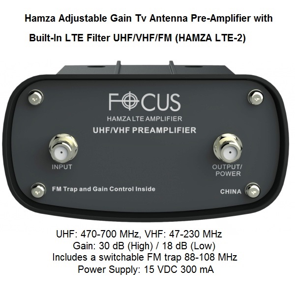

or the HAMZA 1515HD
https://forum.tvfool.com/attachment....5&d=1564442634
That looks interesting, but I have no experience with it.

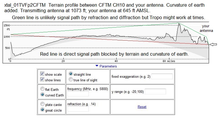

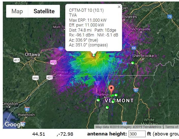

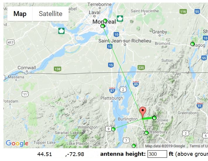

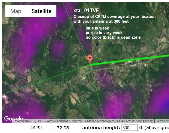

rabbit73 30-Jul-2019 2:12 AM
4 Attachment(s)
The green signal line to Canada on the TVFool Interactive map doesn't even come on until I raise your antenna to 300 feet.

xtal_01 30-Jul-2019 2:49 AM
Like I said ... I need a kite!
Exactly ... like I said, I am in a hole here ... right down in the lowest part of a valley ... the river that runs in the base of the valley is my one property line.

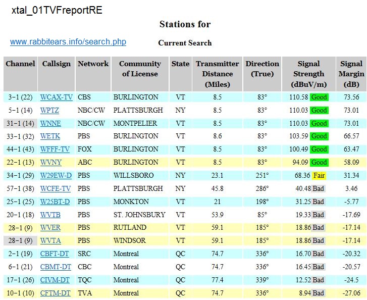

rabbit73 30-Jul-2019 3:22 AM
2 Attachment(s)
This is an image of your TVFool report:
https://forum.tvfool.com/attachment....2&d=1564453289
This is a report from rabbitears.info which should have a more accurate list of channels:
https://forum.tvfool.com/attachment....3&d=1564453312
