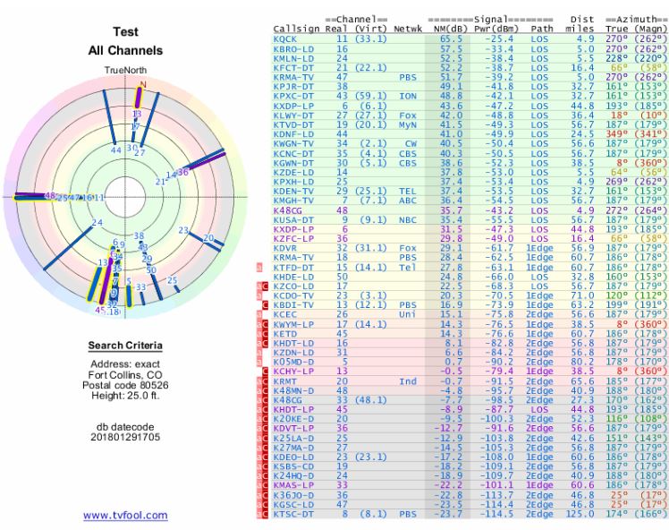

This is an image of your report:
https://forum.tvfool.com/attachment....0&d=1556922332
Here is a report from rabbitears.info that shows two ABC transmitters that will display 7.1 for ABC on your TV, KMGH and possibly KZFC-LP:
https://forum.tvfool.com/attachment....1&d=1556922372
KMGH is on VHF-High real channel 7. Your antenna only has a simple dipole for VHF-High that doesn't have much gain.

I suspect a problem at KMGH’s LPTV station in Fort Collins. Both KMGH and the LPTV station would appear as 7-1. I doubt that your existing antenna is capable of picking up KMGH on VHF from Denver.
