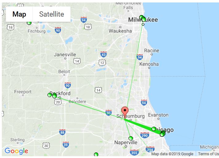

Following is my reception report: http://www.tvfool.com/?option=com_wr...9038ff1d2ad6ea

Hello, ChicagoNW; welcome to the forum. Thank you for the signal report. You are doing very well with your indoor antenna; your signals in green are very strong.

Your goal will be difficult to achieve. Your local signals are much stronger than the signals from Rockford and Milwaukee. You will need a preamp for Rockford and Milwaukee, but it would be overloaded by your local channels.
Also, your antenna should be aimed at the transmitters, so you would need a rotator or separate antennas.
My advice is to keep your system simple and stick with the locals with your CS2MAX in the attic or outside.
You can, at a later date, add a second antenna and preamp to experiment with Rockford and Milwaukee.

Since Rockford and Chicago are 180 Degrees apart, you could remove the reflector on your 4228 and really get both cities. Credit and Thanks to Rabbit73:
https://forum.tvfool.com/attachment....4&d=1552311565
Just an idea.
It's worth a try!
