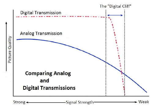

I remember as a kid my dad had an antenna that we could get DC, Baltimore, Norfolk, and Philadelphia channels from about the same location as I am now.
That was in the days of analog TV, when we could tolerate a little snow as the signal got weaker. Digital TV is different; it's all or nothing as it gets weaker.
