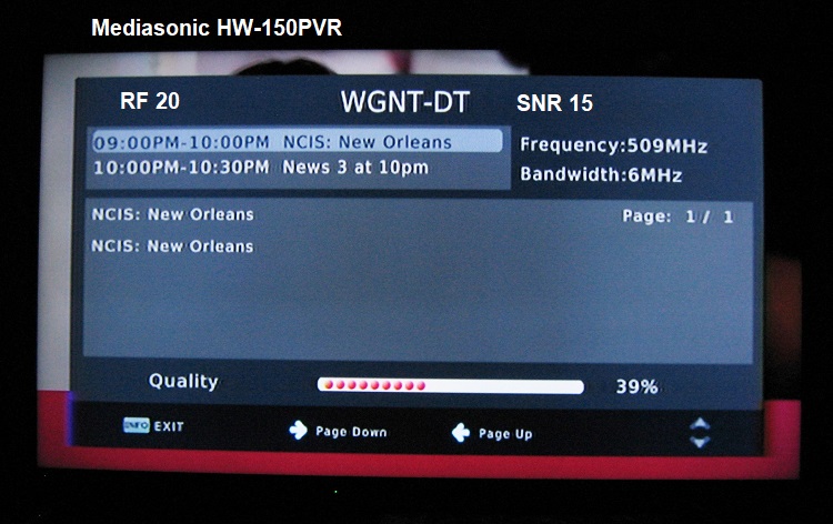

Tyler has a lot of good ideas. One of the converter boxes that he uses is the Mediasonic HW-150PVR. It has a signal quality indicator that is very useful.
Signal dropout is at about 39 to 40%:
http://forum.tvfool.com/attachment.p...7&d=1600712295
It also is able to add a channel after scan so that you don't have to rescan if you change antennas or antenna direction. A lot of TVs can't do that.

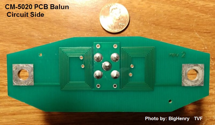

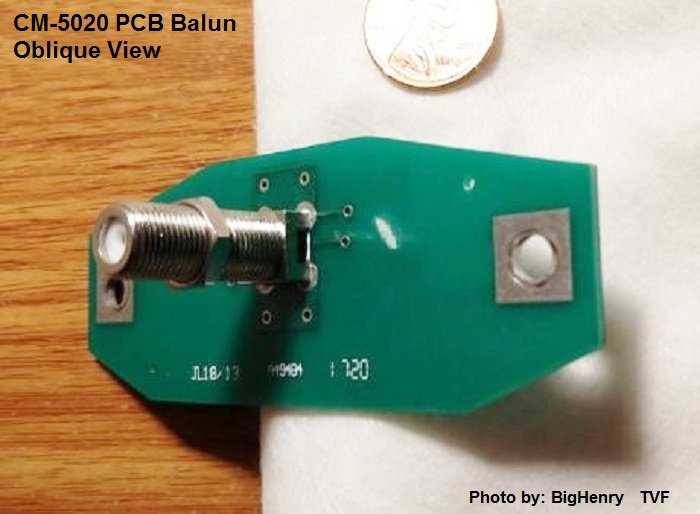

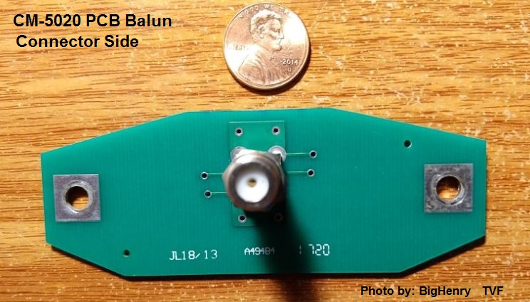

Did you see this thread by BigHenry? He has a CM5020 and had balun problems.
https://forum.tvfool.com/showthread.php?t=16704
https://forum.tvfool.com/attachment....1&d=1577038712
https://forum.tvfool.com/attachment....2&d=1577038735
https://forum.tvfool.com/attachment....3&d=1577038755
He replaced the PCB balun with a CM94444 balun. It didn't work too well until he shortened the leads to 2-1/2" as I had suggested in my balun tests.
