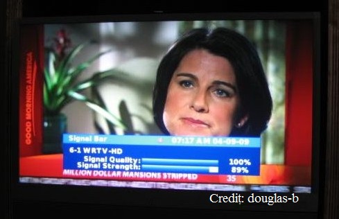

My next question is regarding aim. How would the antennas be able to be aimed precisely (particularly critical for the 91XG) because its not like that part of the roof is able to be walked around on like where it is located now.
Interesting question. The initial aim can be done by using the green signal lines (90 degree vertical map, not 45 degree bird's eye) shown on the satellite map. They are based on true north, so you can aim the antenna at a landmark on that line. You can also use a compass with the magnetic azimuth.
I have found that the best aim for an antenna is not always where you have the greatest signal strength. I was doing some experiments using an Apex DT502 converter box that has two signal bars; one for signal strength and one for signal quality. When I rotated my CM4221 UHF antenna slightly to the right, the signal strength went down very slightly, but the signal quality increased a large amount.
http://forum.tvfool.com/attachment.p...1&d=1416535089
As you have already learned, what good is a strong signal if it also isn't a high quality signal with few or no errors?
You are now a member of the Antenna Measurements Club, because you passed, with flying colors, the initiation when you did the attenuator measurements. When you increased the attenuation, the SNR dropped down to below 15, and you saw an increase in uncorrected errors.
To make the final aim of an antenna, increase the attenuation until the SNR gets down to about 16, which is just above the "digital cliff." This is where the aim is most critical. Then rotate the antenna slightly each side of that aim to look for a increase in SNR, and a decrease in errors.
The see how well your 91XG is doing, try the attenuator test in its coax line between the amp and the input of the AC7. Add enough attenuation to bring the SNR down to 16 dB. This tells you how much "fade margin" you have at that location to deal with changes in signal strength.

rabbit73 22-Nov-2014 2:57 AM
1 Attachment(s)
Originally Posted by mulliganman (Post 47913)
Yeah I am going to hopefully present the options again tomorrow. I know you mentioned about the gage before. What is the primary difference between the 16 and 18 gauge. Does one hold up way better than the other or something?
16 gauge is thicker metal than 18 gauge; greater strength and less flexible. I could have read the specs wrong.
This antenna on the Winegard mount looks to be about the same size as the 7694.
