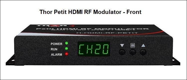

My use is very simple. I don't have a UHF signal generator, so I use the NTSC video carrier of the modulator as a constant strength test signal. All I have to do is select an output channel on the Agile Modulator and tune my signal level meter or SDR to that frequency. It isn't necessary to modulate the carrier, the video carrier exists without video or audio input.
http://forum.tvfool.com/attachment.p...1&d=1606500200
For VHF, I use a more sophisticated (and expensive) source; I generate an ATSC 1.0 carrier with my Thor Petit Modulator.
http://forum.tvfool.com/attachment.p...3&d=1606503206
http://forum.tvfool.com/attachment.p...8&d=1606517223
http://forum.tvfool.com/attachment.p...9&d=1606518082
Testing the Thor Petit HDMI RF MODULATOR

For VHF, ... generate an ATSC 1.0 carrier with my Thor Petit Modulator.
Doesn't the Thor Petit also cover UHF?
Yes, it does, but I didn't have it at first because it was so expensive. I waited until it went on sale, which it is also now again.
The video carrier is more precise; the ATSC signal is much wider and not always flat. So, where do you measure the ATSC Carrier when it isn't flat? My SLM takes an average of many readings when it scans the whole ATSC channel, but can measure the NTSC video carrier more exactly. With the SDR, I can select the measurement frequency at any place on the ATSC channel.

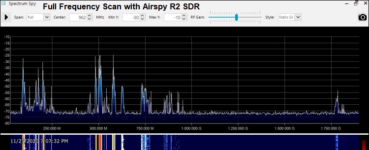

tripelo 27-Nov-2020 9:56 PM
Thanks for the images.
Looks like displays from three different STL-SDR units,
that is if the RTLSDR Scanner is running on one of the lower cost devices?
When comparing the SDRplay and the Airspy,
noticed the noise spectrum on the lower frequency side of Channel 3 is different for each.
Specifically, the noise is increasing near lower edge of Ch3 for the SDRplay,
for the Airspy decreases a bit near lower edge of Ch 3.
Wonder if that reoccurs, repeatable?
rabbit73 27-Nov-2020 10:52 PM
1 Attachment(s)
That is correct. The last three images were:
1. RTL-SDR.COM V3 dongle with free open-source Scanner software from GitHub
2. SDRplay RSP1A SDR with SDRuno software
3. Airspy R2 SDR with Spectrum Spy software that is included with the SDR# (SDRsharp) software download
Yes; three factors account for that:
1. The noise floor is not constant on VHF, especially VHF-Low; the scans were done at different times
2. The RSP1A with the SDRuno software is limited to a useful bandwidth of about 8 MHz; each side falls off pretty fast. The Airspy R2 with the Spectrum Spy software has an extremely wide bandwidth for a scan only limited to the full bandwidth of the R2.
3. The bandwidth of the antenna
http://forum.tvfool.com/attachment.p...0&d=1606523160
