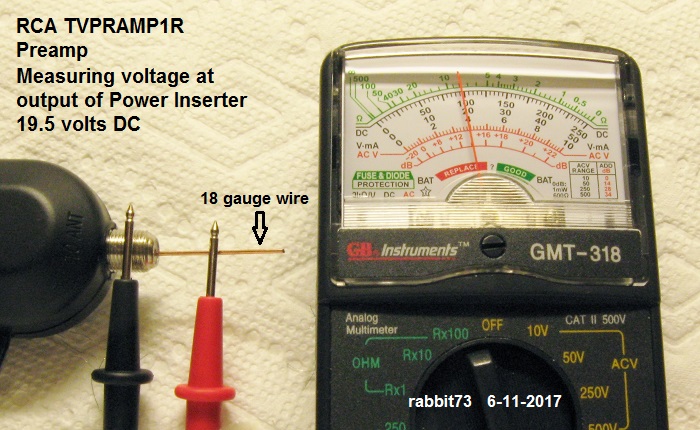

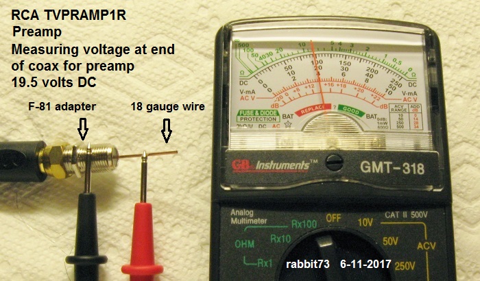

There are some voltage tests you can make on the RCA preamp:
http://forum.tvfool.com/attachment.p...6&d=1512417272
http://forum.tvfool.com/attachment.p...7&d=1512417300
When the preamp is connected, the voltage will drop. It is necessary to use a T-adapter to have access to the center conductor to measure the voltage when the preamp is connected:

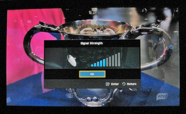

PS: How do you check signal strength in various locations?
The answer by jrgagne99 is correct. Use the TV that has the best signal strength meter; all you need is a relative indication.....more is better.
This is from my 19" Samsung TV:

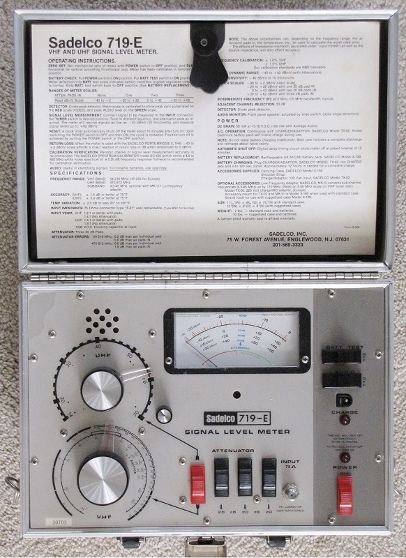

Signal level meters are expensive.
http://forum.tvfool.com/attachment.p...1&d=1440873529
I like to make antenna measurements, so I'm willing to spend the money. I bought the Sadelco 719E meter on the left when I retired from the government in 1988; it was $600. My wife gave me the Sadelco DisplayMax 800 meter on the right as a present; it was $1000.
Since that time, I have bought several meters on eBay, but I don't bid any more than I am willing to lose if a return isn't possible.
This one was $75 including shipping:
http://forum.tvfool.com/attachment.p...8&d=1512491679
