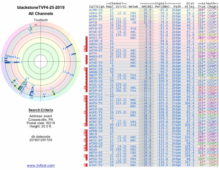

Thank you for the update with your report of improved reception.
Your current TVFool report doesn't list WPGH because of database errors used to generate the report.

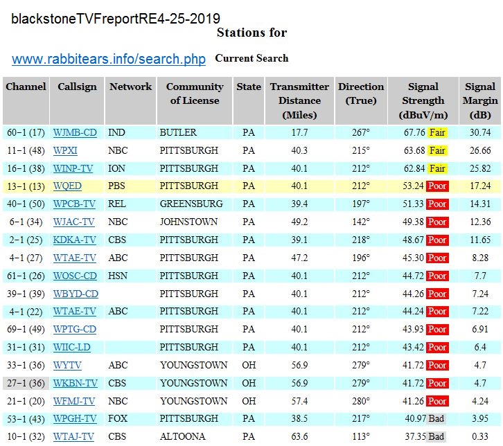

However, a report from rabbitears.info does list WPGH, and its list of channels should be more accurate. WPGH is listed as much weaker than your other channels.
