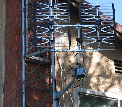

Pete Higgins 7-Oct-2013 12:46 AM
Satellite dish mount on tower leg
1 Attachment(s)
tripelo,
I finally modified the satellite dish mount that I removed from one of my rentals and attached it to the west facing leg of my aluminum tower. Attached my one remaining RCA 5-wire rotor and with a short piece of schedule 80 PVC, my HDB8X 8-Bay Bow Tie. I angled it so that I can rotate the antenna between 169 deg. (the San Diego UHF stations) and 292 deg. (the LA UHF stations). Moving it ~15 feet north and being able to rotate it for maximum SNR gave me a 2-3 dB improvement in signal strength even though its physically 6-10 feet closer to the ground.
http://forum.tvfool.com/attachment.p...1&d=1381102988
The HDB8X still won’t get channel 43 (CBS 2.1) but has channel 36 (NBC 4.1 & .2) as well as channel 31 (CW 5.1, .2 & .3) booming in (SNR’s ~ 28.5-.7). My 91XG on the tower is getting channel 43 with an SNR of 19.9 – 20 .5 but has channel 36 dropping in & out and jumping between 0 and 17.1 with lots of correctable errors. It does a little better with channel 31, holding a steady 21.1 with no errors. TV Fool lists channel 31 @ 2-Edge -103.8, channel 36 @ 1-Edge -107.7 and channel 43 @ 2-Edge -112.9.
The LNA-200 is wedged in place, mid-way between the horizontal cross braces, by the right panel's reflector end cap. Seems much more secure than using the supplied black tie-wrap! Mounted this way I'm not seeing the overload I saw when it was mounted on the mast, below the antenna.
GroundUrMast 8-Oct-2013 7:56 AM
Hi Pete,
Have you considered mounting the LNA-200 inside the tower leg? (Hoping/testing for some shielding effect.)
Pete Higgins 9-Oct-2013 3:46 AM
GroundUrMast,
No, I haven’t. Wedging it between the PVC mast and the plastic end cap was a convenience to keep me from climbing off the patio roof and running to the garage to get another tie-wrap. Success was accidental!
I have thought about mounting it in a metal box to see if that would help but the RCA amps I bought seem to work as good (maybe even better), support dual inputs and cost a lot less, so I’m not sure it would be worth the effort. I can’t fathom how sticking it in front of a piece of PVC and partially behind a reflector rod could provide much shielding. Other than relocating the antenna & the amp., everything else stayed the same (panel cables, combiner, combiner to amp. cable and cable to garage).
