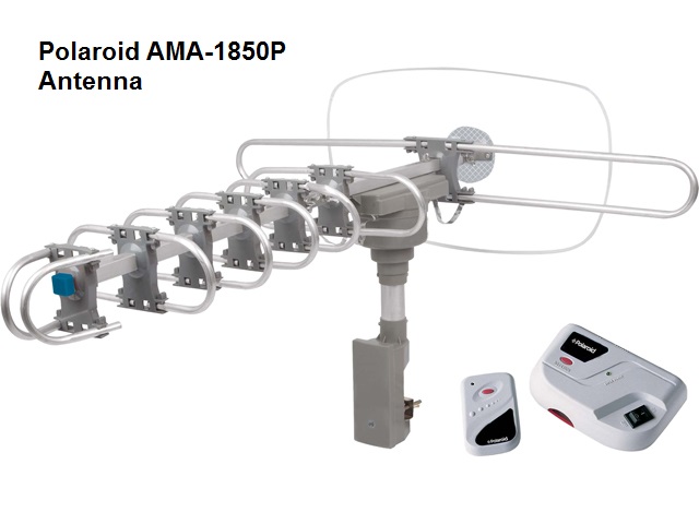

It is a Polaroid AMA-1850P
blackstone 1-Dec-2017 3:38 PM
My mini experiment with the motorized cheapy.
It's standing about 6'
Manually adjusting without the rotor I got RF 51, RF 38, RF 43 and RF 25 as well as 32? Virtual 6 from Johnstown
Those weren't very fine adjustments that I could make with the rotor.
Not sure what this is telling me.

Your Polaroid antenna has a built-in preamp. It is telling you that your Channel Master antenna needs a preamp up near the antenna.
http://forum.tvfool.com/attachment.p...6&d=1512180723

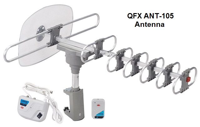

The photo of the Polaroid antenna shows the front director folded forward, which is odd. And the reflector at the rear is unusual; I can't tell what it is made out of.
The similar QFX antenna has the front director folded back like the rest of the directors.
http://forum.tvfool.com/attachment.p...7&d=1512182545

The Polaroid will work on VHF, but only for very strong signals, because it has a single folded dipole for VHF. WJAC on UHF channel 34 is at 142 degrees, and WWCP on VHF channel 8 is at 158 degrees. You would need a UHF antenna and a VHF antenna combined with a UVSJ just for the SE.
