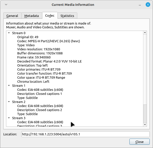

ckwsp101_tv 22-Apr-2023 7:02 PM
1 Attachment(s)
Will view the mentioned references.
Turns out SD Extend transcoded streams did not saturate my obsolete home network.
Need newer switch to support multiple Flex 4K ATSC 1.0 streams.
I'm time shifting OTA shows to bypass commercials.
Fewer network concerns with ATSC 3.0 streams.
1080p/60 coming from ATSC 3.0 station :>
My VLC client cannot decode AC-4 audio :<
https://forum.tvfool.com/attachment....1&d=1682185656
