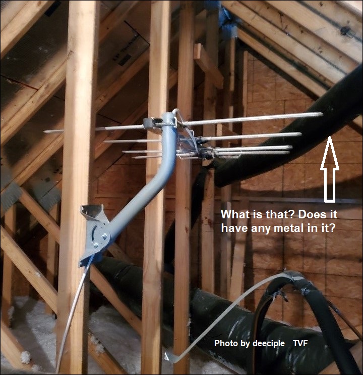

I am getting pretty good results from the attic install. Albeit, the more windy days do present a problem for me, but I am not sure the roof install would improve that much. The trees around me are very tall. Plus, the safety factor of climbing up there...

deeciple 2-Jun-2021 10:26 PM
Originally Posted by rabbit73 (Post 63606)
https://forum.tvfool.com/attachment....3&d=1619980706
Thank you for the photo of your antenna in the attic. I see a black pipe or duct in front of the antenna. If it contains metal or foil it might block the incoming signals.
Hi Rabbit73,
I know this is an older thread but I am thinking about moving my antenna up higher to see if I can clear that duct and get better reception. I am noticing that whenever the air handler kicks in my reception is affected.
I have radiant barrier to the left and right (on the slopes of the roof). If I go up higher, do you think that the reception will be worse due to the narrower wall in front of the antenna, with the barrier being on either side?
Thanks,
Ken
rabbit73 3-Jun-2021 2:06 AM
Originally Posted by deeciple (Post 63662)
Hi Rabbit73,
Hello, Ken
That sounds like intermittent electrical interference. The antenna must be near the source.
It's difficult to predict. If there is no metal in front of the antenna to block the signal, it might improve the reception.
deeciple 3-Jun-2021 2:20 AM
Yes. I tried to get it as far away from the air handler as possible but it is about 4' away. I actually had tried moving it from it's original location but did not see any real improvement. If I raise it higher I could get it 6' or more away from the air handler. My only concern and why I didn't mount it higher was the narrowing of that wall due to the pitch of the roof.
It's definitely worth a try as raising it higher will clear that duct as well as get it farther from the air handler. I will give is a shot this weekend and let you know how it goes.
