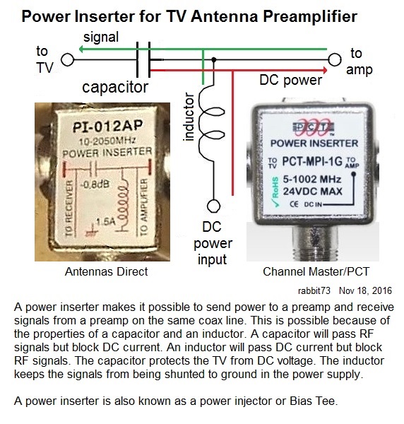

Not sure what you mean by a power inserter
The power inserter is part of the preamp system. It makes it possible to send the DC power up to the preamp AND send the signals down to the TV on the same coax line.
https://www.channelmaster.com/TV_Ant..._p/cm-7777.htm
manual
http://downloads.channelmaster.com/S...77_7778_UG.pdf
http://forum.tvfool.com/attachment.p...1&d=1496676770
http://forum.tvfool.com/attachment.p...1&d=1496676876
