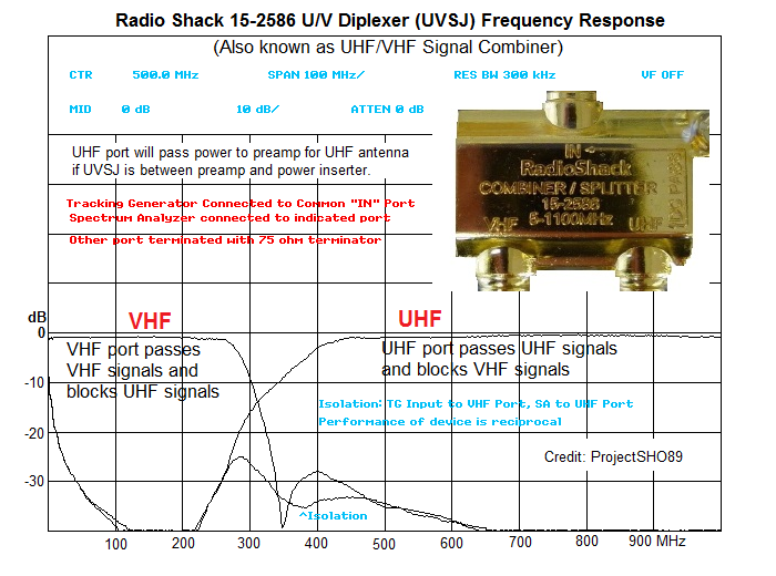

Here are the curves for the Radio Shack UVSJ:
http://forum.tvfool.com/attachment.p...2&d=1494007033

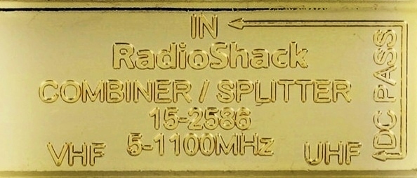

If you look closely at the Radio Shack UVSJ, you can see the DC pass arrow going to the UHF port. This would allow you to insert a preamp between the UHF antenna and the UVSJ to amplify the UHF signals, but not the VHF signals, which is not what you need.

The label on the Radio Shack pkg is misleading:
http://forum.tvfool.com/attachment.p...1&d=1494370999
It is described as a splitter for two components, which is not correct.
