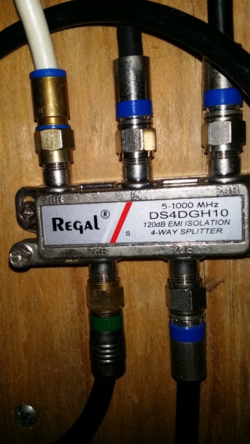

He has what appeared to be a sophisticated distribution with at least 10 Coax cables routed all over his house by way of all kinds of splitters and an amp:
I imagine this is left over from his Direct TV installation. Seems like it may have been used as an attenuator & 7db loss on all ports? Wow! :
http://forum.tvfool.com/attachment.p...1&d=1477578876

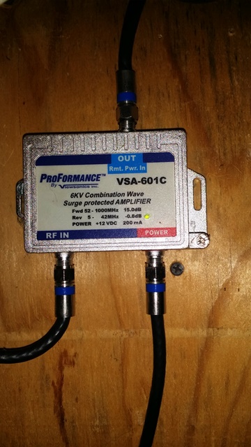

Now his amp. Does anyone know if this will work for his antenna system, should he want to hook up the splitters again and send signal to each room? Or is it an satellite only amp? I saw no amp up on top of the roof. :
http://forum.tvfool.com/attachment.p...1&d=1477578941

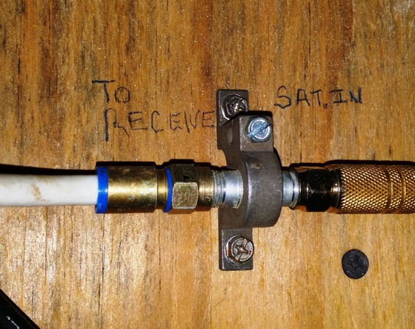

To simplify things, I just ran his antenna lead direct to this connector, and ran one lead up to his tuner. That got him 75-80 % on Sony signal meter on most strong Chicago stations:
http://forum.tvfool.com/attachment.p...1&d=1477578978

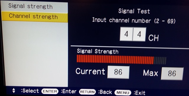

Anyhow, here's a photo of his Sony signal meter, his strongest channels. The channels displayed are the REAL Channels:
Channel 7.1 WLS (ABC)(UHF)
http://forum.tvfool.com/attachment.p...1&d=1477579029

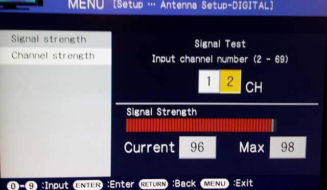

CH 2.1 WBBM (CBS) (VHF):
http://forum.tvfool.com/attachment.p...1&d=1477579086

The splitter and amp are probably left over from a CATV setup, neither are suitable for satellite. Both may, however, be used for antenna signals assuming they're still serviceable. I've never seeing either branded item before but both appear to be typical for their genre.
Glad it's worked out for the guy.
