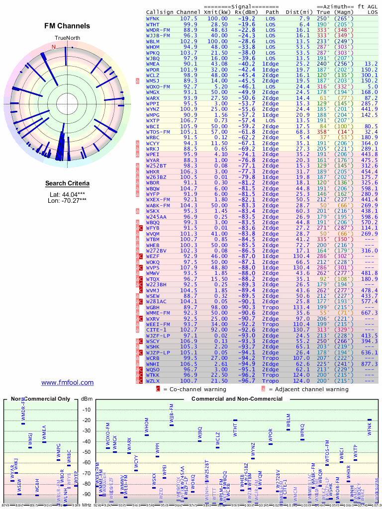

Originally Posted by Ellie View Post
Only problem is, still no PBS channel 10.1 (VHF)... Silly question, but -- could FOX channel signal be overriding PBS channel (see analysis chart in original post)?
I'd doubt that Fox is the issue. You have two strong FM stations that could be problematic.
When strong FM stations are an issue there needs to be an FM trap between the antenna and the preamp. This limits your choices of antennas to unamplified and if you must use an amplifier, get an FM trap to install between the antenna and an external preamp.
